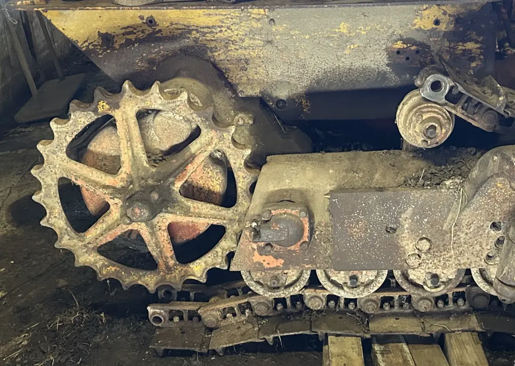

Hi. D2 5U -> sn 5U16708, Master Pin. It has a hole on each end. same size, maybe an 1/8" deep. I assume this is the master pin. Can you strike it out from the Outside towards the centreline of the machine or from the inside towards the outside of the machine or does it not matter (either way). Thanks

On your machine, it will drive inwards pretty much wherever you have positioned. However, it is usually recommended to have it positioned in a convenient location over/around the sprocket for a more solid base to strike against.

If your intent is to go into the steering clutch, sometimes one can pull the front idler back far enough to gain enough slack to flop the track off without having to drive the master pin out. Same with putting it back on. Of course, if the machine is the off color caterpillar, the dozer would have to come of first. As Deas said, freeze the master pin, warm up the links helps put the master pin back in. I would hope you had already cleaned both the track bosses and the pin before trying to re-install. (some better pictures of the track, bushings, rails, idlers, sprockets. I wonder about the sprocket pictured front segment at the spoke looks pretty worn.) - CTS

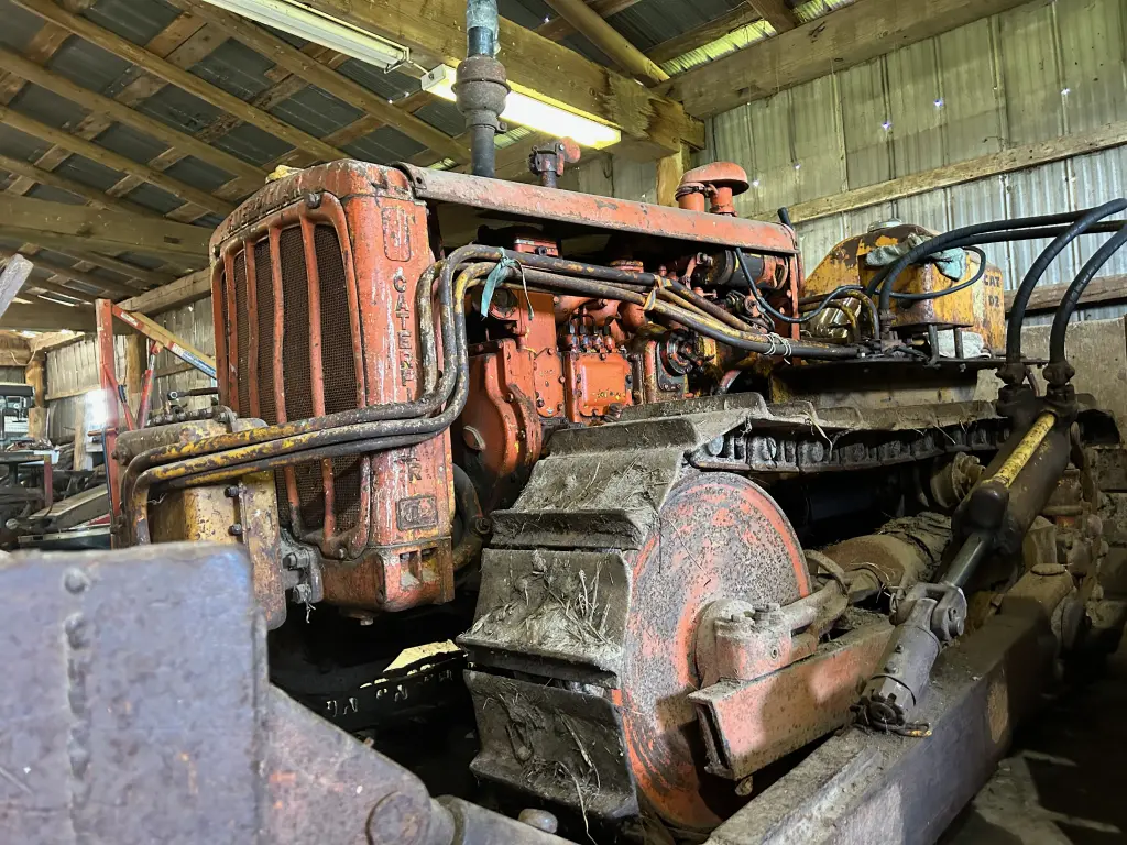

Thanks. On the 5U do I have to take the entire track rail (with the rollers) off to remove the rear clutch/brake/final drive assembly ?

I'm no 'ex-spurt' on D2s but I think you can remove the sprocket-final drive assembly in one piece without removing the whole track frame.
Seems to me that you might have a 5-bottom-roller track frame there.
