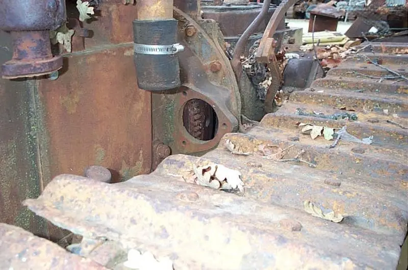

Here's a pic of the ring gear on a parts 20 I have. Kind of hard to get to for removal. Karl 530-533-2266
[attachment=15462]005.jpg[/attachment]
I didn't get a chance yesterday to look but, i will try today. I didn't see the thread you were talking about with the rear start, that does sound interesting because i was kind of thinking to come of the back shaft to start it, using pulleys and a kicker motor but I'd rather come up with a more permanent solution like the starter that's suppose to go in it, eventually I would like to restore it but for now I want to get her back to work.
Also want to say thank you for all the pictures and info, when I find out if i have the ring gear or not i probably buy your if possible.

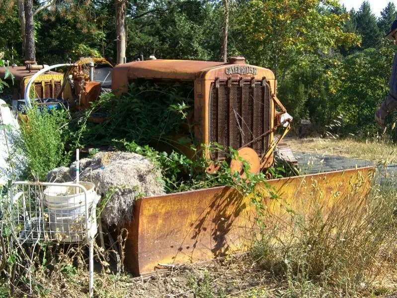

Found this pic. from the past. This is a simple way to have them start easy. A lot of tractors in our area were done like this in the 1970's to help them sell. This is a CAT 28 with a 20 rad. Bill
ya it doesn't have one, but i am interested in getting one if anyone had one and is willing to part with it let me know, let me know the price and shipping. Actually any parts for the 28 or will fit on the 28 let me know eventually i want to restore it, so any info that can help let me know paint, engine parts, carbs, intake, exhaust, distributor, ect.... really appreciate it.
