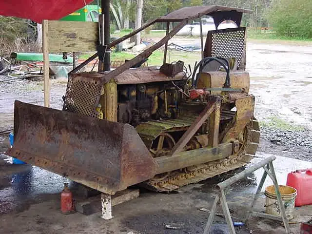

I might not know them if I did, but I'm relatively sure that they're not here because neither of the D2s have electric start ponies unless you count the fender mounted belt drive starter on the "conglomeration"
I need to dig out the pictures of it when I got it home. It was a sight!
Tue, Mar 6, 2007 12:57 PM
here's the "conglomeration" in it's native state, just off trailer😄
note the creative use of belly pans from other (deceased?) D2's
