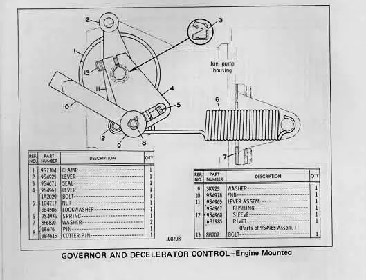

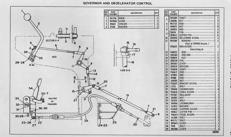

My info shows a 61Gxxxx Military Tractor as being a D7F equivalent to a 94N1 to 94N5191
Here's the image for the early 94N...
 [attachment=73597]D7F Decelerator.jpg[/attachment]
And at the Engine...
 [attachment=73600]D7F Decelerator #2.jpg[/attachment]
Wed, Sep 6, 2023 1:46 AM
61G is a D7F model and would have a D333 engine, 1970 year of manufacture, 4YB would be D7G series.
