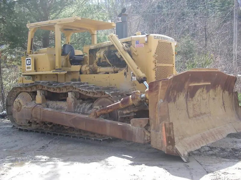

Hi, Roydsracing.
As I understand it, there was no specification for a ROPS canopy for the 14A/15A D8's, hence no specifically designed ROPS mounts. ROPS canopies didn't come in until the later model D8H's and D9G's.
When they did come in, there was some fairly extensive bracing under and around the mounting points to carry the loadings required by the ROPS specification. I have attached 3 photos that may give you some idea of the extent of this bracing. If you look carefull under the fender of the D9G with rear cushion push block, you can see a brace made of heavy flat bar bolted to the outside of the main frame and curving up under the fender to support the front ROPS mount. This was a standard Cat part for these machines with bolt holes in the main frame to accomodate it.
The D7G's, D8K's and D9H's were built with heavier fenders and built-in bracing to accomodate the ROPS.
I seem to remember that the early specification for a ROPS canopy was that it had to take weight of the machine dropped on it from 10 feet up and remain substantially intact. THAT would need some solid mounts and mounting points.
That was why anything even vaguely approaching a ceritifed ROPS would have needed some substantial welding to mount on a 14A or any other tractor of that vintage.
Hope this helps.

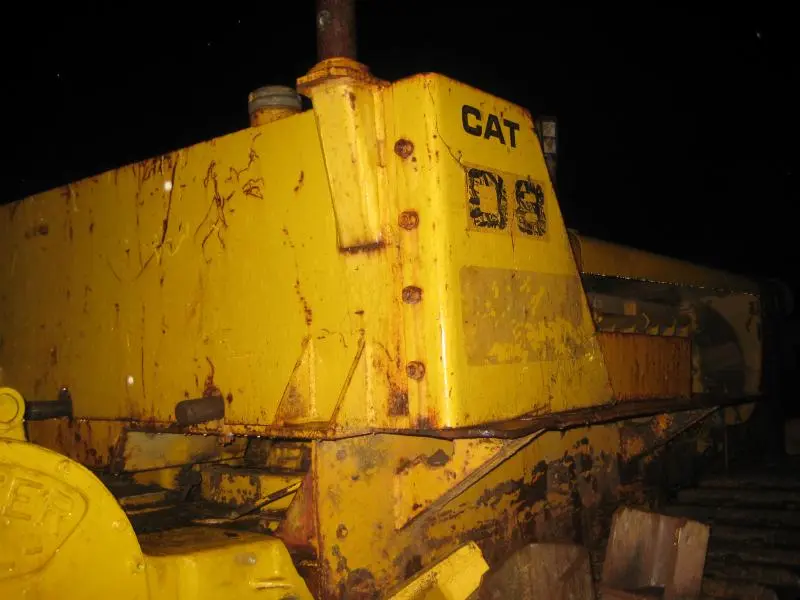

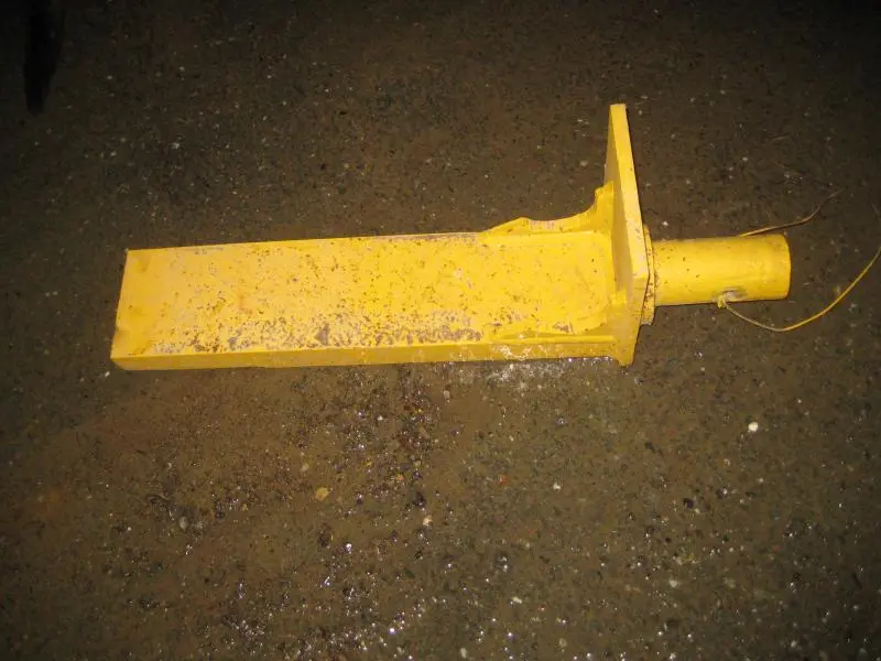

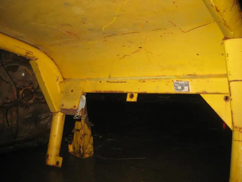

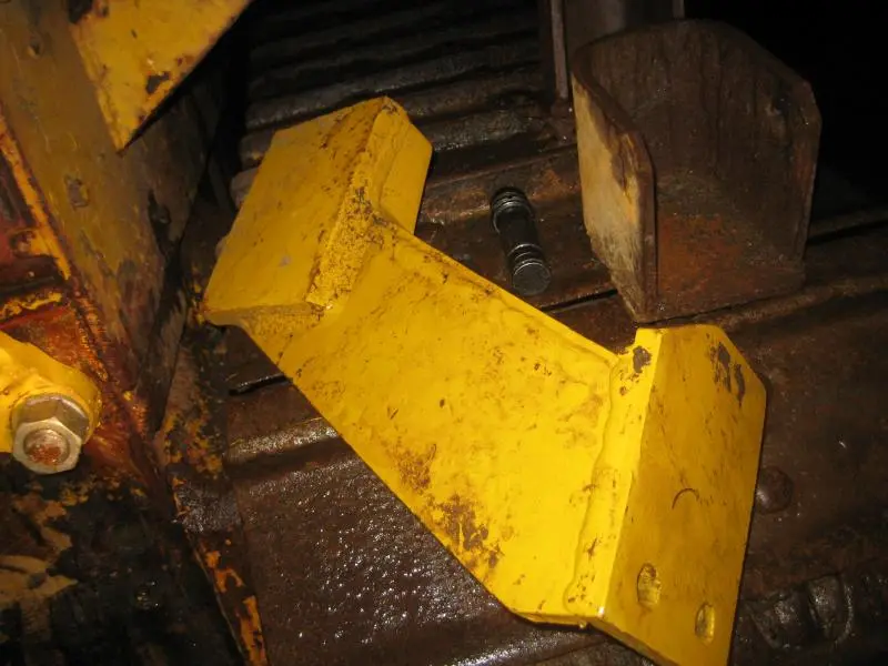

Glad you popped in on this one. I've a had lot of discussion about ROPS with different local contractors and friends. I'm hoping to do some work for Cal-Trans this summer and they check the ROPS, seat belts and what ever else. Everyone that has looked at the info label has agreed it is a true ROPS. The tag is hard to read, but it does specify a California approval number. It also is designed for 14a model. I find it interesting it was built in 1974... almost 20 years after the machine was built and it's not like Cat built these for many years like the 46a.

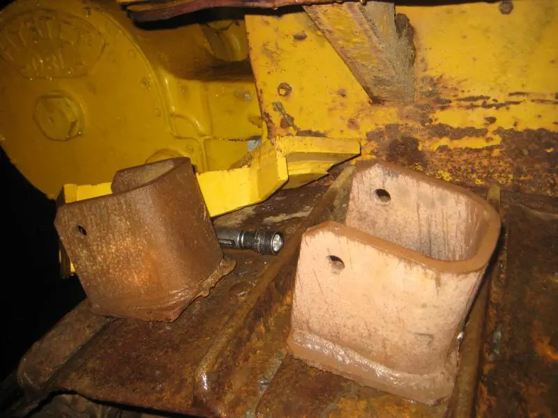

So I'll try to describe the pics.. The rear tank guard has mounts that weld to the frame under the fender, that's the part laying on the track that's painted. A portion of the fender has to be cut out behind the tracks. The center mounts weld to the frame at about the rear of the engine. That's the yellow mount on the ground. The bottom engine side panels came with the canopy and are shaped differently than the originals. (I think I just stumbled onto my starting point for positioning the canopy). The unpainted parts on the tracks are mounts for the sweeps. Check the extra steel on the shots of the underside of the canopy.
[attachment=7722]redbluffprogram 004.jpg[/attachment][attachment=7723]redbluffprogram 002.jpg[/attachment][attachment=7725]redbluffprogram 006.jpg[/attachment][attachment=7724]redbluffprogram 008.jpg[/attachment][attachment=7726]redbluffprogram 005.jpg[/attachment][attachment=7727]redbluffprogram 012.jpg[/attachment][attachment=7728]redbluffprogram 010.jpg[/attachment]
Thanks for the interest and Happy New Year to all! Must be summer in your part of the world Deas and all you Aussies. We've been dealing with floods and cold, but a weekend to work on D8#2 is great even in the cold! Wife thinks I'm nuts.. got a nice shop with a wood stove and I could be working on my Bonny low rider, but no there that bitchin D8 right outside the door. Yellow fever for sure.

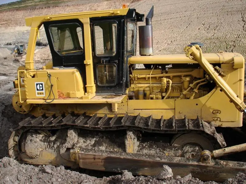

Before you go any further with that project, I think I would be inclined to contact Cal-Trans with photos of your caopy and ALL the information off the ID plate, INCLUDING the Gross Vehicle Mass if it is there and readable and I'd ask them if the jigger would be suitable if properly mounted.
Why I am suggesting this is that if you compare the canopies in the photos that I posted with your Medford canopy, the canopies in my photos look far more substantial and there is not all that much difference in the weight of your 14A and a D8H.
If that GVM panel does have a readable figure in it, it would need to be up over the 50,000# mark, possibly nearer to 60,000# to be of much benefit. I don't know what Cal-Trans standards are. I am just going on what I understand the specs to be for a certified ROPS. That is why I suggest that you approach Cal-Trans and ask them before fitting it. I think it would be a little disappointing to say the least to fit it, then have them inspect it and knock it back.
I am not trying to dampen your spirits here. I AM trying to help you to make sure that you aren't wasting your time. I think doing a little homework first may be a good investment.
If you think it will help, please feel free to click on my name and send me an e-mail.
Hope this helps.

If you take a look at the canopies on Glen's 14A and his brother's as well, you will see they both have RHS - square tube - in the rear legs as well as the front ones. It's that round tube in the rear legs of yours that has me wondering.
If it all checks out, I think I would start with the back mounts first 'cos you can always set the canopy up on the back mounts and support it while you get the weld-on front mounts set in place and welded.
