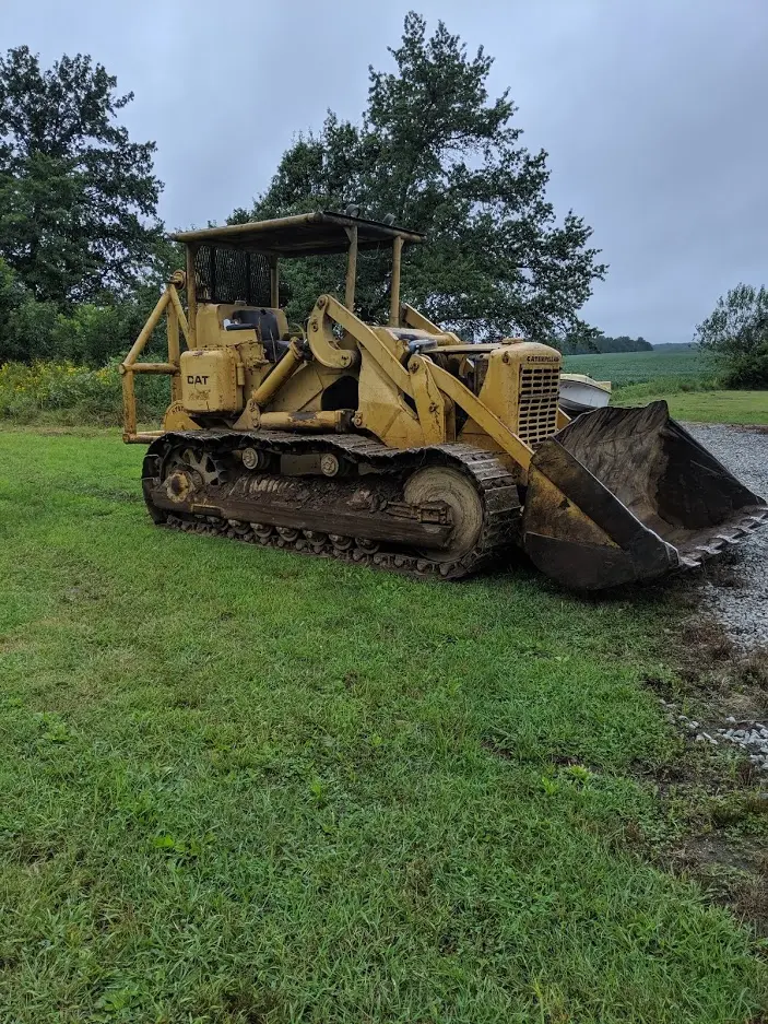

Hello, new member, just got my first cat yestereday, been having a blast pushing trees, not really sure what it is, anyone have any idea on a series or a place to download an operators manual? The tags have been painted, gonna try acetone on them today, found one on each side and one up by drivers seat. Machine is a mess that is for sure hopefully we can keep it running.
I'm not sure where/what all needs oiled.

Looks like a 977, 20Axxxx series.

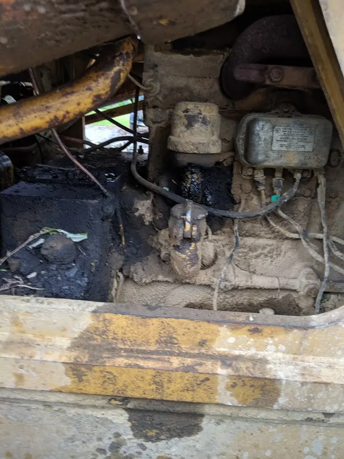

Can someone give me a hint on what kind of oil goes in here?[attachment=55114]IMG_20190827_084349.jpg[/attachment]

Uncovered another dipstick just towards the rear of the engine oil, guessing it's the clutches.
uncovered the tag on engine block but haven't been able to make it out yet everything was spray bombed on this tractor also a hint to where at in the rear
still gotta find a service manual if anyone has a digital copy would be much appreciated
Your machine is 977 serie 20a with motor 318 and the dipstick on cluch housing is for the wet cluch and you use the same oil than motor
