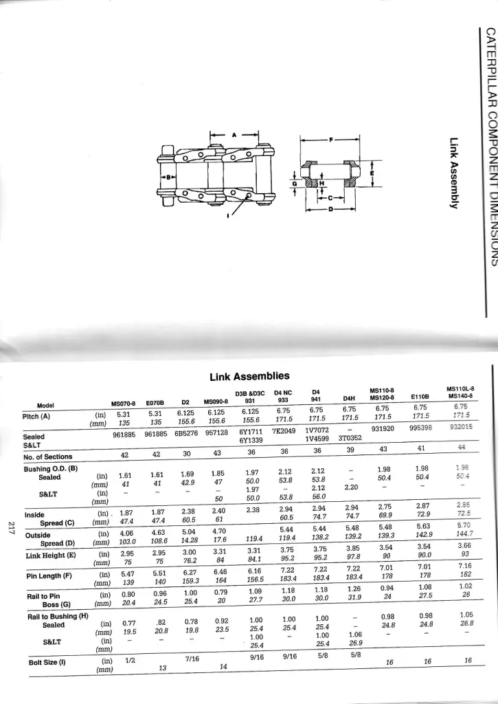

Posts: 4,027
Hi Mike,
here you go from a Caterpillar Undercarriage Conversion Guide, Form No PEGP2806, Rev 04, 1991.
Fri, Oct 22, 2021 6:12 AM
Mike Meyer
Posts: 3,336
Thank you received: 5
Reply to edb:
Hi Mike,
Thankyou for the scan Eddie, my 1989 Cat undercarriage book shows the D3 NC and 931 NC have a bush outer diameter of 1.85", and that is the size I'd need for my 2 Ton chains, not the later beefed up bushes of 1.97" as shown in your book.
All the best
Mike
Fri, Oct 22, 2021 6:47 AM
Posts: 4,027
Reply to Mike Meyer:
All the best
Mike
you will find that the chart lists many options and the MS090-8 has 1.81 bushes, will these not suit for length then ??????????
Fri, Oct 22, 2021 7:07 AM
Mike Meyer
Posts: 3,336
Reply to edb:
How long is the MS090-8 bush Eddie, and pin diameter, I can't see that dimension in the books, or am I really going blind? LOL
My 1989 book list the MS090-8 bush as having a outside diameter of 1.85"
Fri, Oct 22, 2021 9:05 AM
