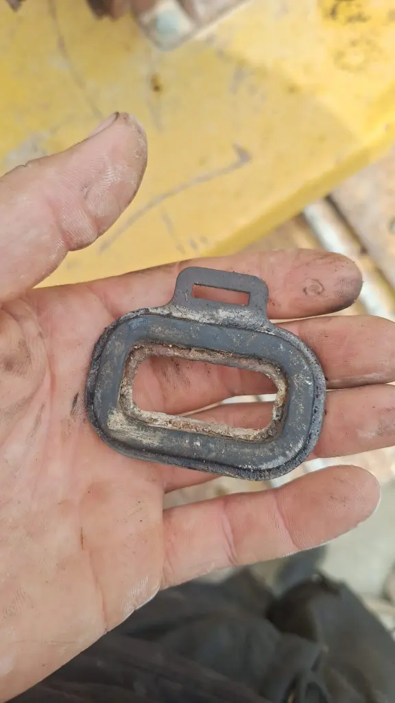

I also need a rubber seal that fits between the two engines but could not find part number - picture attached
Can anyone help me or else advise where I could source these?

Not being familiar with the D2 stuff I could be wrong. But Cat was big on using big thick o rings. After being smashed for 50 to 75 years when removed they look like they started as a square seal but are not. Just a common o ring.

You sure you’re working on a D2 and not a D4, only reason I ask is because the picture of the gasket that fits between the two engines is for a D4? That gasket from Caterpillar I think is also around $115.00 now so if it’s not in bad shape reuse it.
Thu, Jun 5, 2025 4:54 PM

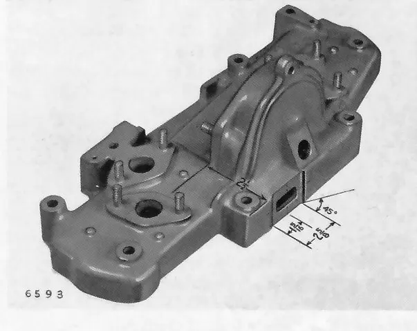

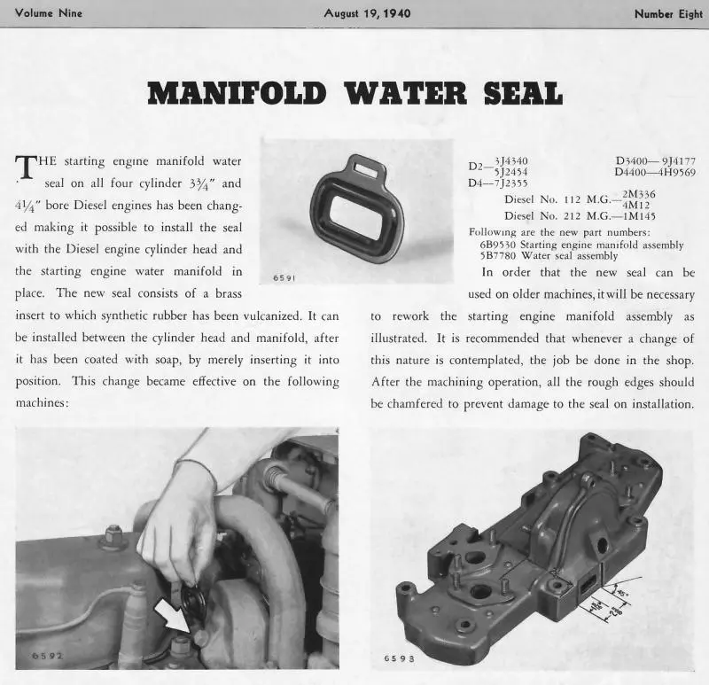

Hi Clayton, you can use them on both. There's an instruction where the top edge of the top cover can be rounded so that that gasket can be slipped in without disturbing the pony. I put one on my 5U after rounding the sharp edge. Man, that price is up there isn't it.
Here's the instructions (hopefully...):
Thu, Jun 5, 2025 6:48 PM

Hi Neil yes you are correct, IG1990 sorry for the incorrect info, the price is rather steep I feel.
