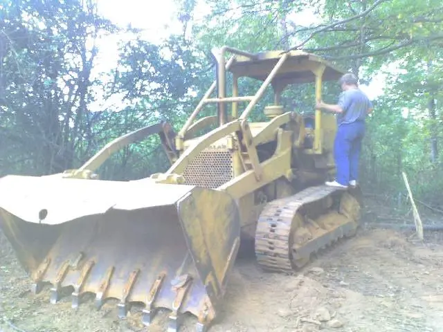

I'm looking at purchasing a 955?? H maybe? I couldn't find/see the serial number or data plate. The machine has a 4 cyl turbo diesel, runs ok, its a 2 speed power-shift, I think, with a small "tower" in between the brake pedals that has the throttle, start switch and i figure a light switch. It will need rails, but otherwise would do fine for the farm work and occasional grading job. I'd like to figure out what year this might be, any issues with these machines or anything to be aware of, etc. Thanks for any help in advance. I use to have a 933G and should have never sold it, hindsight being what it is.

Does sound like your eyeballing a 955H 60A model. Produced from 1960 to 1967. They made a little less than 14,000 of them. Early models up to sr. #9693 had the D330a engine which was not one of Cat's finest. The later D330c (4-3/4 bore) is an improvement.The early engines are prone to head problems and spun bearings. Over the years they made some improvements but you'd want to check the engine over closely. Rest of the units were ok as far as I know (occasional final drive problems). If it's in good shape your light use will probably give it a long life.
Yes, it is a 2-speed F/R transmission.
If you could swing it I'd recommend you go for the later K/L model with the D330c or the 3304 preferred, final drive improvements and 3-speed power shift
