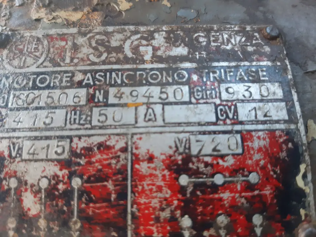

They had set up a old D4 sprocket with a hydraulic motor to wind the chains up and down, so that will be handy, and it has the grouser bolt driver too, so I'll be busting the heads off bolts in no time, only problem is have no idea what all the controls do, and I need to learn everything I can before I use it. The other problem I have is it is run by a big old 3 phase electric motor of about 11hp running around 910rpm, and I don't have 3 phase power at my place, so I need to either find a old slow revving 3 phase diesel generator around 25KVA, or set it up to run off the PTO of my tractor.

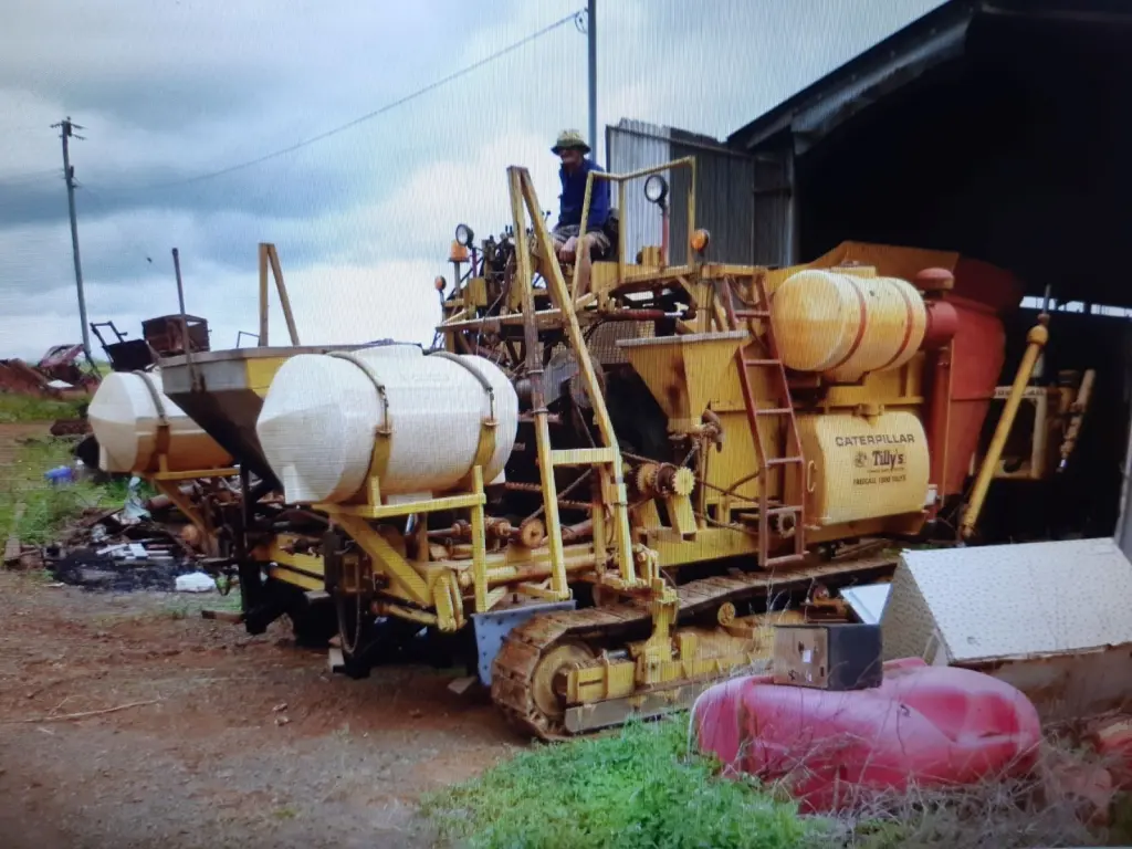

That last photo is the sugar cane planter Joe designed and built himself, he found a 3208 engine that had thrown a conrod, so he repaired that engine and it has been running great the past 12 or so years, the machine runs on D4D chains, and applies the fertilizer and other chemicals in one pass, it was the first machine of its kind in the world.

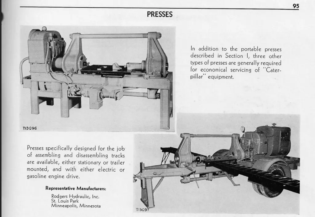

Are you sure that is a Berco Press? Looks a lot like the press featured in the 8th Edition Caterpillar Service Tools Catalog. Unit actually built by Rodgers Hydraulics, Inc. St.Louis Park, Minneapolis, Minnesota.

OK Bob, thanks for that info, the bolt heads on it are definitely metric sizes, 22mm and 24mm, and the big old 3 phase electric motor driving it is definitely Italian, the data plate on it is all Italian writing, not a word of English.

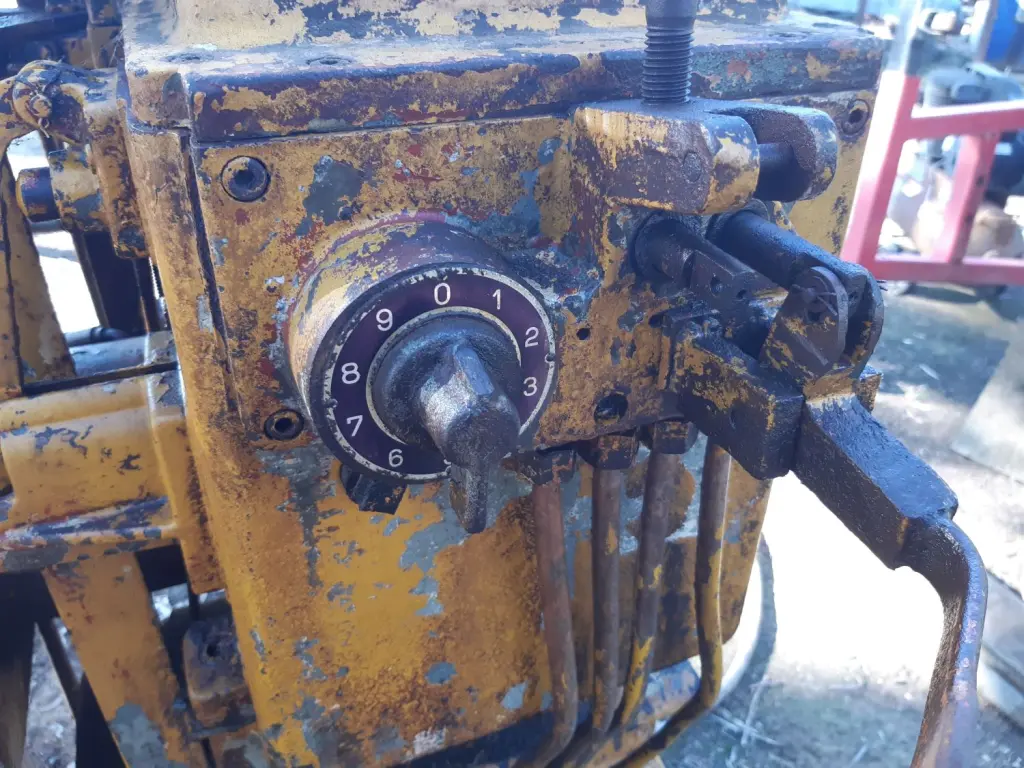

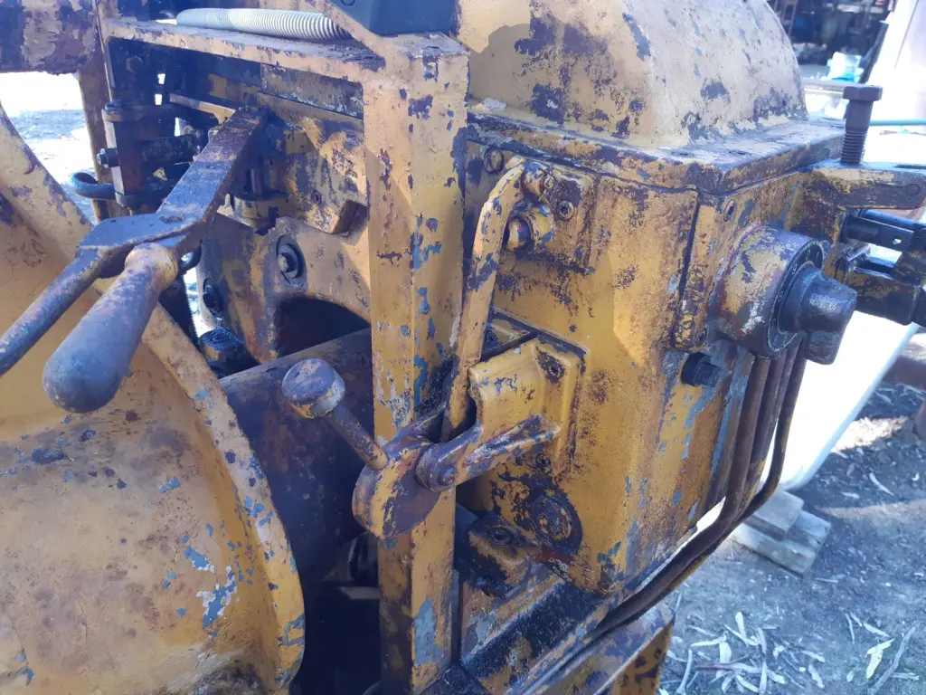

Here are a few more pics, Pete, I only have a later edition of the Cat Service Tools book, so can't see the unit you are referring too.

Here's what's shown in the 8th Edition.....

Thanks for the picture Pete, what year was that 8th Edition published? That Rodgers press does look very similar to my Berco press doesn't it, do you happen to know what model number that Rodgers press is?
