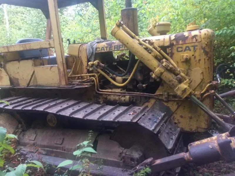

Hey Guys, new to the forum. Been googling around recently and stumbled upon your forum and read a bunch of good stuff so i figured i'd join up and ask my question directly.
I own a small excavating company. I'd like to get myself a smaller dozer. I've been looking around for a good D3 or a D4. Figure it'll be a good size for what i do. There's a D6 for sale as well for around the same price but i think that's too big and too much of a pain to move.
Anyways, i found one on facebook. Guy is asking $6k. I don't know anything about these. It's an older one. I think 70s but that's a complete guess. I'm going to go look at it this weekend. Is there anything i should be looking for in particular? Also any ideas on weight of this machine? Google says 18k but this thing looks a bit heavier than that.
Really just wondering if this would be a good first dozer for me or if i should keep looking around and buy something different.
I know these pictures aren't great but it's all he has at the moment.
Thank you!
[attachment=57029]1.jpg[/attachment]
[attachment=57030]2.jpg[/attachment]
[attachment=57031]3.jpg[/attachment]

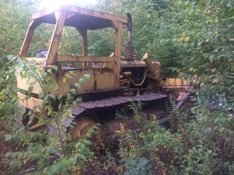

It looks like a D4D. The early ones had some problems, I don't know the serial no break. For the asking price it should be running. It looks like it has been there for years, maybe parked for a reason. Might be one of those scrap price deals.

the serail number is very important for parts---the older Cats had the serial number in two places, the upper left side on the rear steering clutch case, and on the engine block above/behind the pony controls. these were tags riveted on
someone will come along if the location is somewhere else
I find my power shift and pedal steer machines so much easier to run than the old manual ones , and love my D3B with the 6 way blade--so easy to grade with

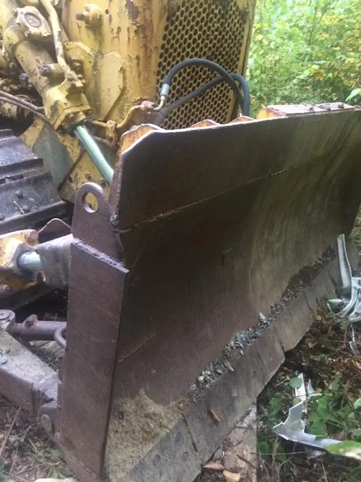

Let me ask, what kind of excavating work are you doing? Keep in mind this has a straight blade. Any old Cat with a straight blade is gonna be a good pushing machine so long as everything works, but there's a reason smaller dozers are now all 6 way blades. If you're doing a lot of topsoil stripping or small clearing jobs this would do pretty well. I've used my friend's D4C for the same and it works great.
If you go the 6 way route you can pick up a good older one like a D3B or C, Deere 350/450, Case 450 etc. for not much more money. I know a guy in Manchester who's refurbing a Deere 350 6 way and will have it for sale in the spring for around $10k if that's something you'd like to try.
