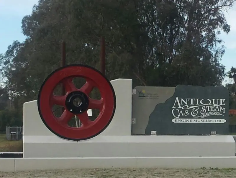

Museum sign of museum at Vista, CA.
Antique Gas & Steam Engine Museum Inc.

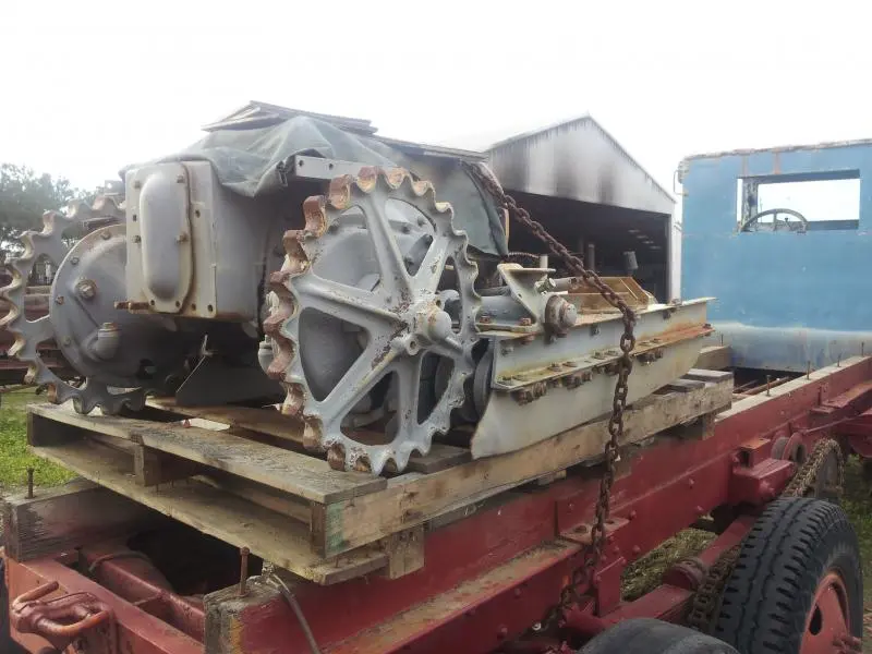

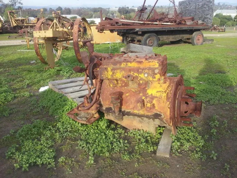

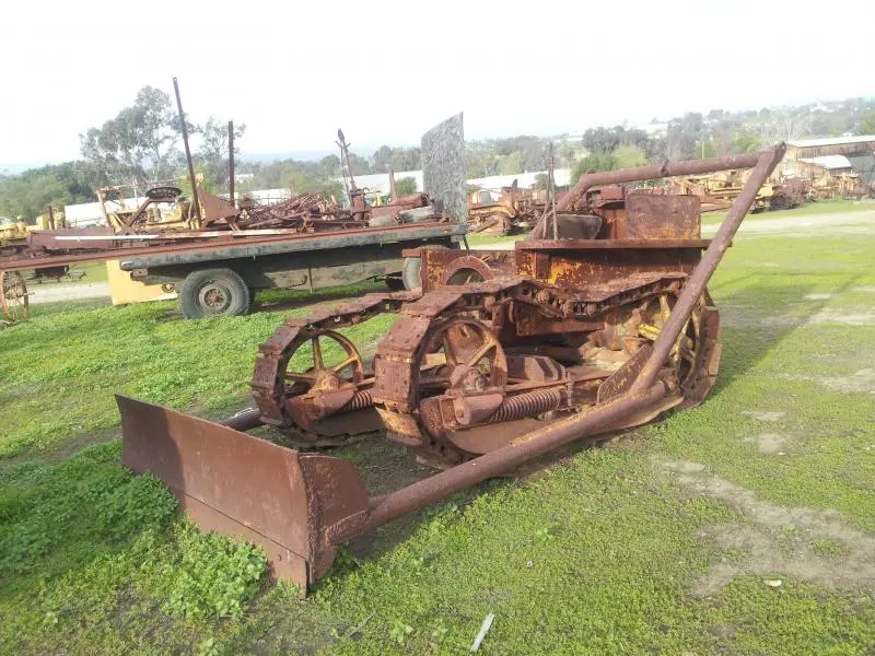

They had one Cat Ten on display. Possible 3 remnants as parts.
8 or so Cat 15s.[attachment=27294]20150104_152428.jpg[/attachment][attachment=27295]20150104_151628.jpg[/attachment][attachment=27296]20150104_151608.jpg[/attachment]

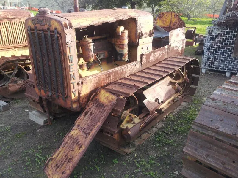

[attachment=27300]20150104_150634.jpg[/attachment]
15 and 20s

i like the No 1 Terracer behind the 20!
Thanks for sharing

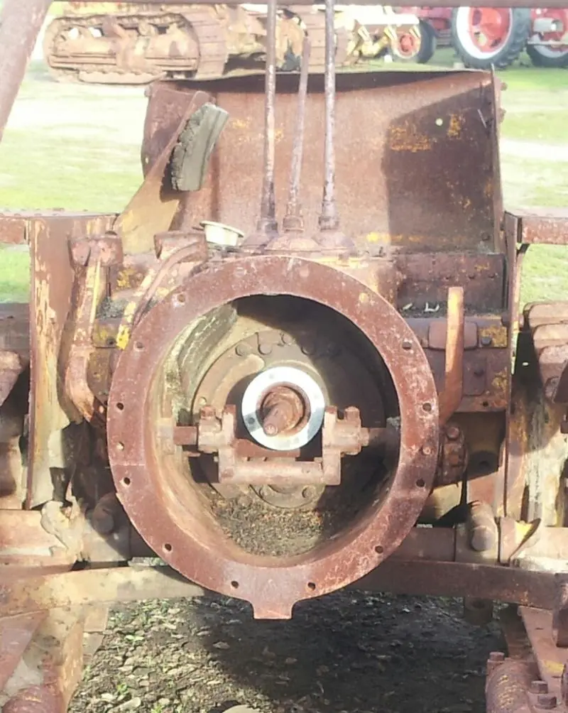

Close up of clutch linkage.

I'll try and answer a few questions about the machines pictured. The first set of a Ten with blade is a tractor owned by one of our chapter members. He has been associated with the Museum for many years and is able to store a lot of his tractors onsite including the blue and red chain-drive 1918? Mack in the first picture. The FIFTEEN with the wood sun canopy belongs to the Museum. The other machines including the 20 with terracer, all belong to another of our members who lives in Long Beach. These guys don't follow the BB but I'm hesitant to name them here for privacy reasons. None of them that I know of, are for sale. I have tried the buy one of the terracers but no deal yet. I'm glad you were able to give us a visit as we think we have a lot of good stuff around to see. Did you get up to the harverster barn to see the 1918 Holt side-hill harvester. It is a gem and in rather good condition. It was donated to the Museum some time back. Our club is investigating how we can reposition all the Cat stuff for better viewing. These things take time.

Can anyone tell me if the clutch fork is upside down on the pic of the engine?It must of been out to take engine out and it has been put back in wrong. My book shows it going on the top with the bolts to the back.for my fifteen.
Thanks stew

Stew,
The picture is correct for a TEN. The yoke is down so you don't block the oil passage for the throw out bearing.
Pat

Blakeystew- For a FIFTEEN, it should install above the bearing as you mention. After seeing Pat's post, I guess the TEN goes under the bearing. Never did a TEN so don't know.

Thank you for your posts.
I will.be attempting to remove the bolts this week to dismount the fork and allow the clutch pack to move forward out of the housing with the engine.
