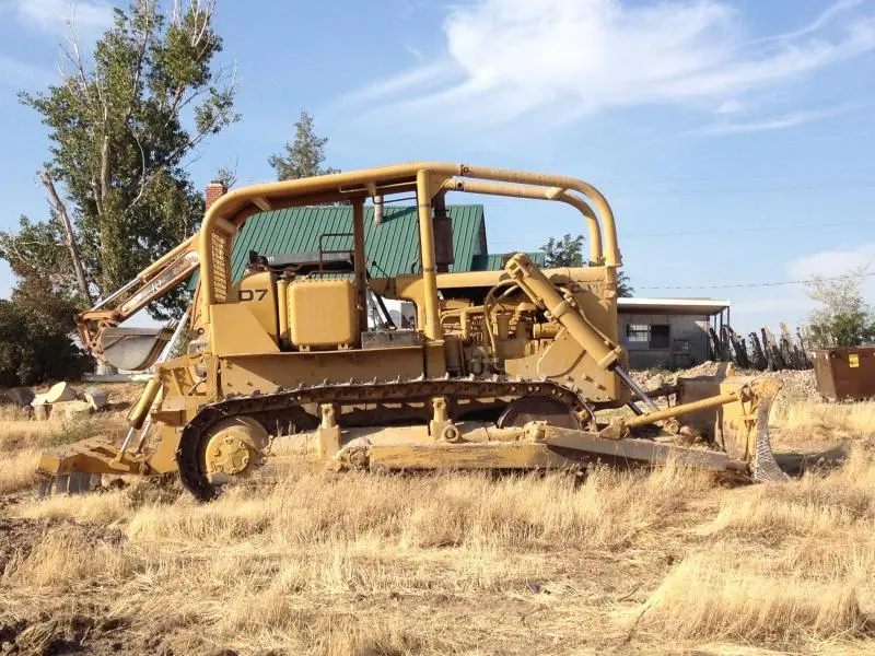

[attachment=14954]image.jpg[/attachment]
Here is the only picture I have, hope to get some more today.

Thats a D7E, 47A or 48A. Pretty cool too. Charlie

Here are the pics I took today, hope they show enough to help.

Nice looking machine.

160hp D7E fitted radial rippers and A/T blade. Late type tracks with alligator link in good condition. Can't see properly in photo's, it appears to be a direct drive. Whatever, it is a very tidy tractor, grab it whilst you can. Neil

The serial# stamped on the back of the machine says 17axxxx. I know very little about these older machines and what s/n goes with which model, did the D7e also carry the 17a# or has this machine been upgraded to look like an E model?

The 17A designation is for D7C/D only so it appears the base tractor is a 17A with a D7E complete undercarriage upgrade. Direct drive, oil clutch and still has the 17A #46 hydraulic control unit. Turbo was an attachment for normalizing beginning 17A1 or could have been added later. All in all a pretty good package once you figure it out.
