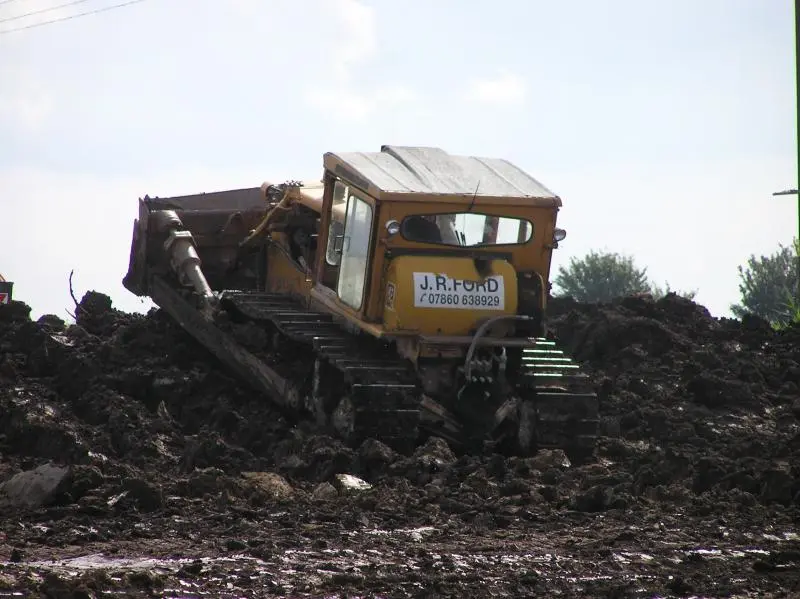

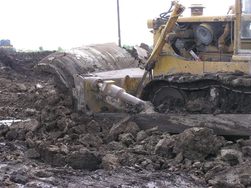

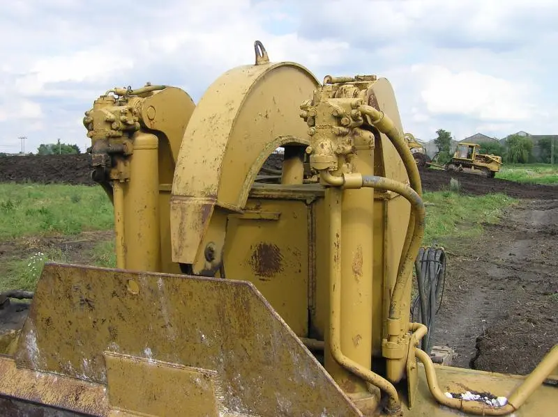

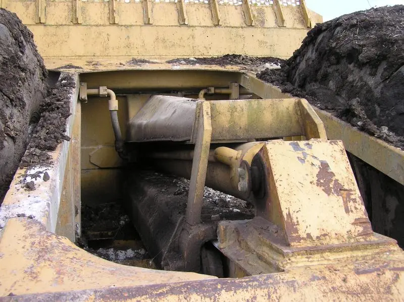

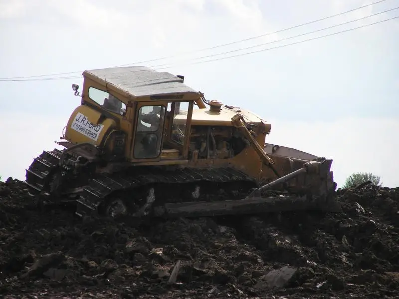

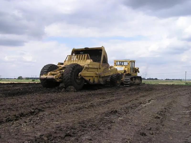

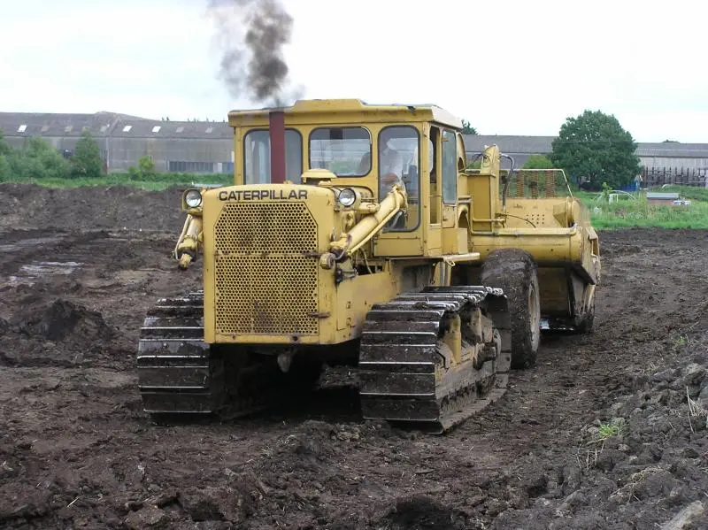

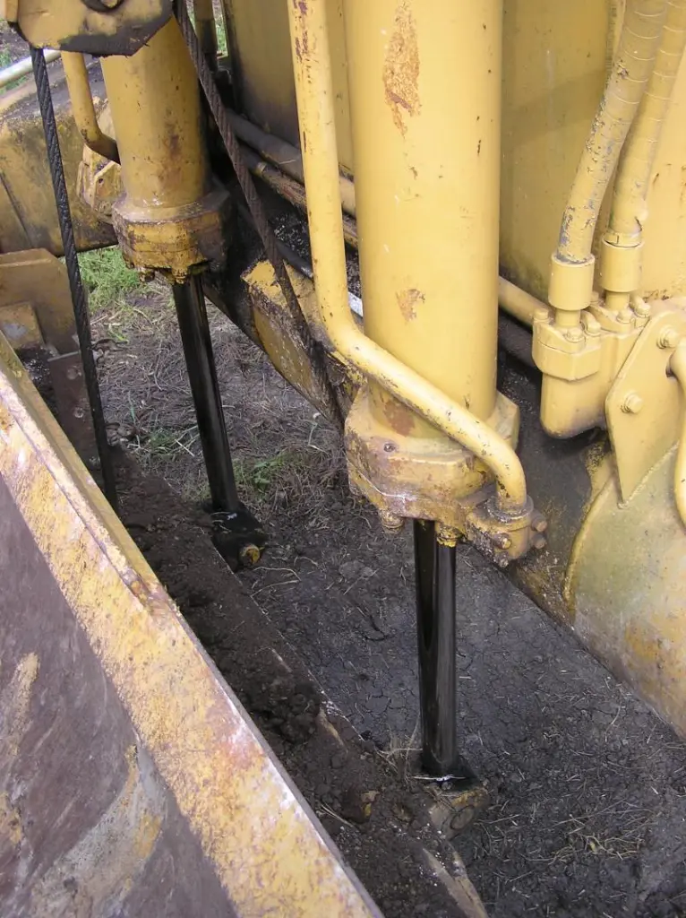

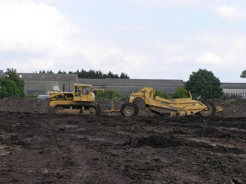

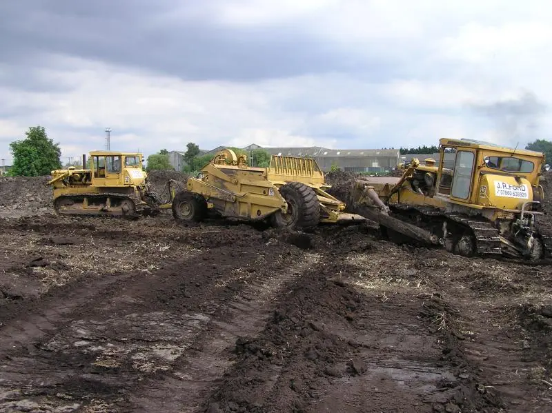

Thanks for the information, I went out to see some Link club friends making a new reservoir with two D8H 68A tractors (These are powershift D8H tractors made in Glasgow in the UK. The Glasgow produced direct drive tractors D8H tractors had 22A serial numbers), one with a blade, one with a scraper box. I've been trying to identify the model of the boxes which were converted to hydraulic operation using parts salvaged from (we believe) model 6x1 motor scrapers.
The location is in "The Fens" near Chatteris and the ground consists of high organic "Black land" overlying brown and blue clays. It's very difficult to get down to the clays due to all the rain we have had recently making "bad muck" of the organic soils.
I've attached some pictures, enjoy !
If anyone can identify the model of the scraper boxes, I would be grateful as I have a feeling the serial number tags will be missing.

Looks like 5Wxxxx series #80 scrapers to me. 15 yds struck, 20 yds heaped.
Are you absolutely certain that it was converted from cable? If so, someone did an outstanding job. It does not have a "cable look" i.e. top of ejector grillwork is different; apron lift arm is different, etc. but looks like it was always hydraulically operated. I'm no expert but I've spent a lot of time watching one of these follow me around all day!-Jan
Hi John
Assume these are all Birtley ones; not genuine US cat ones.
All the Birtley ones had the s/n tags on the r hand side back from where the apron hinges to the box. About where the hyd hoses lead back to the ejector. All Birtley 70 and 80s were like this.
Early versions would have a 'B' in front of the serial number; ie my Birtley 70 is B3W258. 80s were B5W.
Later Birtley scrapers all had there own serial numbers. ie 70 was 91D. Other sizes were also made there No15, 428, 435 and 463.
Was a lot of Birtley scrapers made it to NZ along with alot of wright 40s from south africa
cheers merv
Sun, Aug 12, 2012 12:38 PM
Hi Jan, Yes, the owner had them converted himself and I agree they did an outstanding job.

Reply to Mervyn Pepper:
Hi John
cheers merv
[quote="Mervyn Pepper"]Hi John
cheers merv[/quote]
Hi Mervyn, I will look very carefully next time I visit the site for the serial numbers, I agree that it's quite likely they could be Birtley manufactured boxes. Thanks for the heads up !
