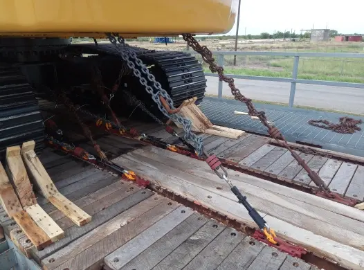

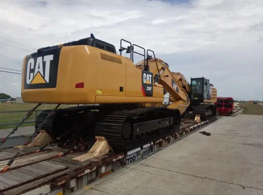

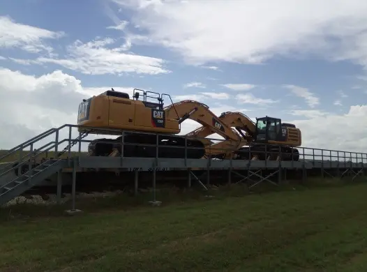

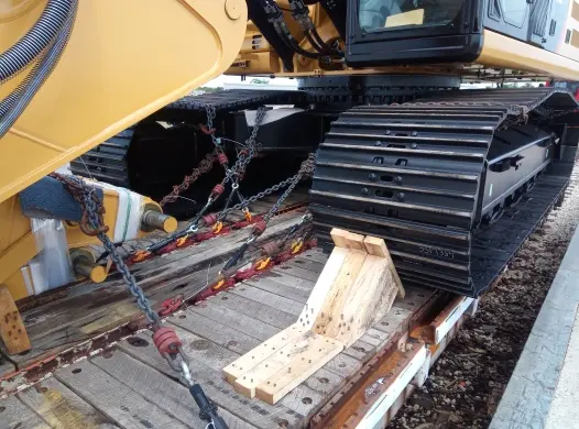

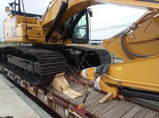

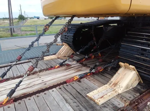

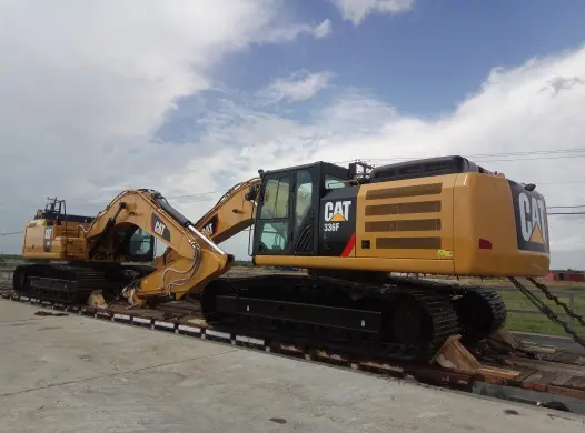

Great discussion. I was in Victoria Tx and saw this along side the road near the Caterpillar Plant. Thought you guys would be interested.
[attachment=57246]CAT 335F Tie-Down 6.jpg[/attachment][attachment=57247]CAT 335F Tie-Down 5.jpg[/attachment][attachment=57248]CAT 335F Tie-Down 4.jpg[/attachment][attachment=57249]CAT 335F Tie-Down 3.jpg[/attachment][attachment=57251]CAT 335F Tie-Down 8.jpg[/attachment][attachment=57250]CAT 335F Tie-Down 7.jpg[/attachment][attachment=57252]CAT 335F Tie-Down 1.jpg[/attachment]
Thanks, yea hauling equipment on rail cars takes extreme tie downs with rail cars slamming back and forth and they do bounce around allot on some of the older rails.
