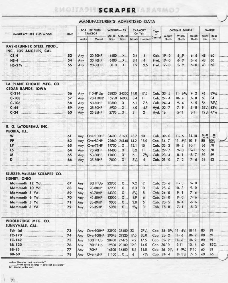

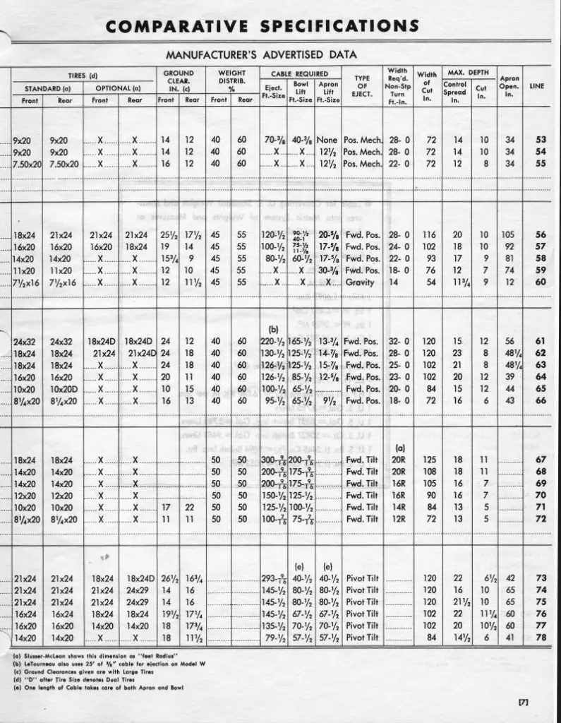

Not sure if it would help, but I have a Cat Dealer Competitive spec sheet from 1951 which shows a LeTourneau models W, FP, LP, LS, M and D. The Model LP weighs 19,700lbs and Stuck 12.1 and Heaped 15 cu yards. It's 32' 2" long.
Probably too new for you, but I could post the info. if it will help.

Ray,
I have a whole 3 ring binder of this stuff, so easier said than done.... I have no clue whether this kind of stuff is commonly available. There are booklets like this on blades, hyd controls, tractors, motor graders engines etc. It came out of a dealer in the 1950's for sales people- How to sell against competitors.
This is just a couple pages from the scraper booklet and the cover.

Very good material thank you

Oldcarman thanks for that info that's gold right there
