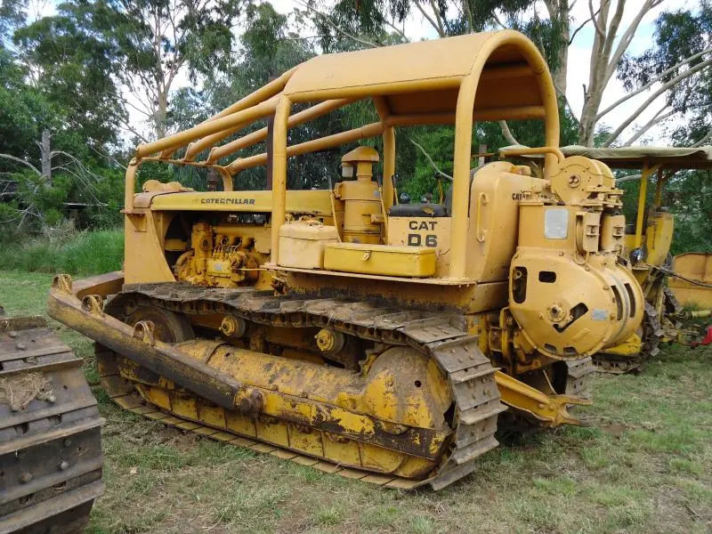

D6 Pete
Posts: 575
Reply to ianoz:
Thanks Andrew , the old girl is out earning its keep .Fence lines and some clearing.
Would put a photo up , But once again the system refuses to load the photo :frusty:
I have all the books ,,, regards pete[attachment=33862]DSC00597.jpg[/attachment]

ianoz
Posts: 850
Reply to D6 Pete:
Ummm , Pete , I think you will find that is a Caterpillar DD-PCU , Not a Le Tourneau one
Sat, Feb 20, 2016 11:59 AM
D6 Pete
Posts: 575
Reply to ianoz:
Wont bother to answer that Ian !!...Ive ran both ..regards pete
