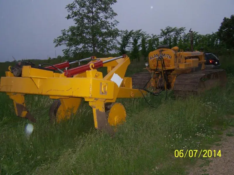

[attachment=55831]D6-9U ripping 06-07-14.jpg[/attachment]
What about putting cylinders on similar to this?

Hi, Folks.
If cable is to be used with a hydraulic ram, you need to MULTIPLY the length of lift movement by the number of strands of cable in the arrangement to get the ram stroke required.
Better, me thinks, to go for an arrangement like that shown in drujinin's photo.

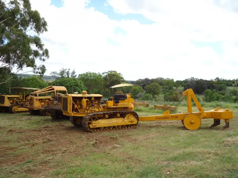

Why not find an old D8 with #25 ... wonderfull old machines .. and pulls a # 28 Cat 3tine no worries !! . [attachment=55882]DSC00592.jpg[/attachment][attachment=55882]DSC00592.jpg[/attachment]
