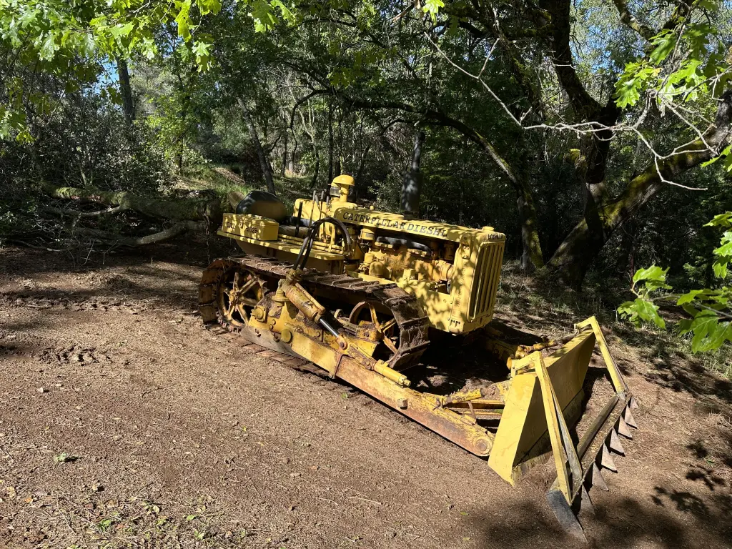

So last week I thought I had it figured out. With some helpful tips I got the D2 pony motor running again. Yesterday it started cold on the first pull. Confident it would start right up again, I shut the cat down for lunch after skidding some trees. MISTAKE!
Nothing. It seems it just doesn't want to fire when hot. I tried all the tricks I learned, but nothing. After a dozen pulls I walked away from it.
I guess I've learned my lesson, don't shut it off till done for the day!
Is this a thing with the pony motors, that they don't want to fire when hot?

Tree in background behind the dozer (maybe oak that has been felled) - looks like it has scars on it from being pushed? I can't make it out well, maybe a chain with hook tied to it behind the D2? Open machine, no protection from anything. Many years ago a friend was pushing cottonwood trees that had been felled, using TD9 IHC. The crotches had not been cut or broken. One reared up, rolled upright and then fell, pinned him in the seat, broke his jaw, and back! Fortunately, other crewmembers were there, cut the log off him and drove him to nearest hospital, 15 miles away. HE WAS LUCKY - HE LIVED! PLEASE BE CAREFULL, it only takes once to ruin your day and maybe your life.

Good morning. Yes, I've been dropping some trees near the house and shop, and skidding them across a draw to a spot where I limb them out, cut firewood, and burn the slash. Getting the last of some late season burning done. The D2 compliments a Kubota mini-excavator, and a JD rubber tired tractor with front end loader, which makes a real nice trio.
I really do want to build a canopy for the D2. I also have property out in bigger timber country. Even what seems to be a small limb can be fatal from a tall tree. I like to think I'm pretty careful, but a canopy is needed. I appreciate the words of caution.
