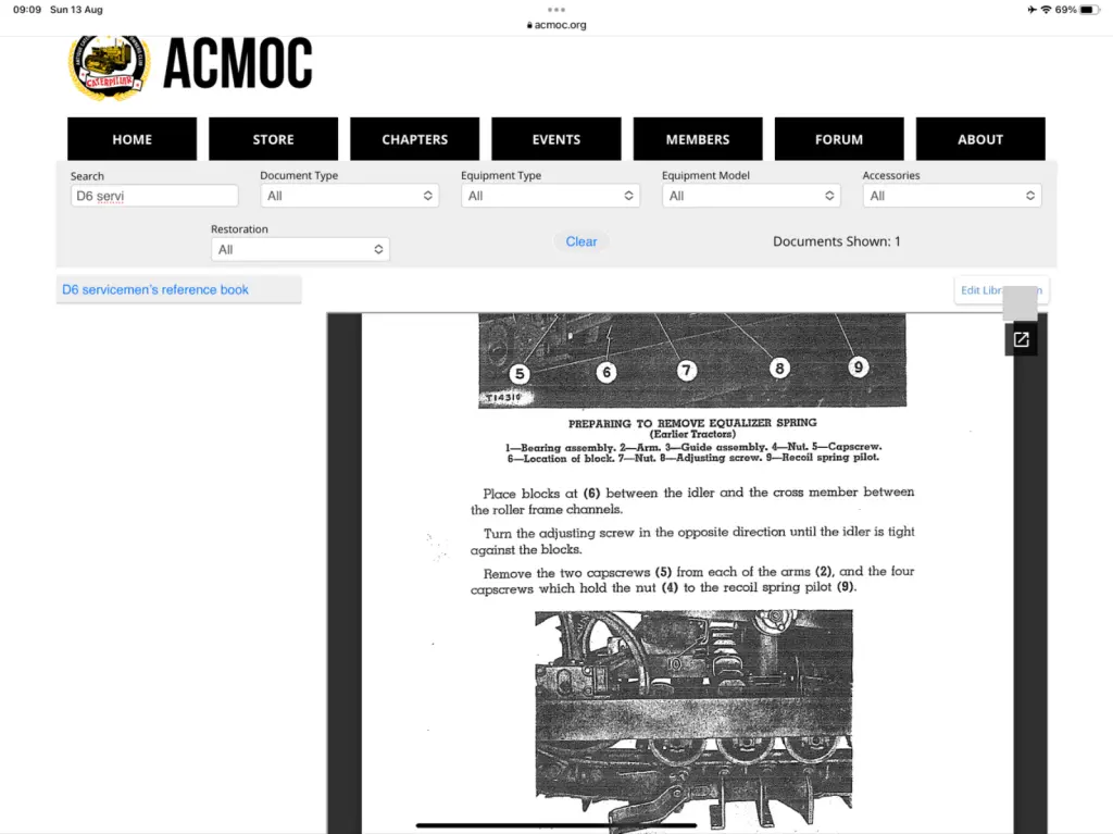

There’s a Servicemen’s Reference Book in the Tech Library. Not the best copy but it shows the procedure. See pic. Looks a straightforward process if you’ve got the tools.
 [attachment=73248]9F008415-D513-47D3-8AC8-67797DB9806E.png[/attachment]
Great info Deebo! Thank you!
