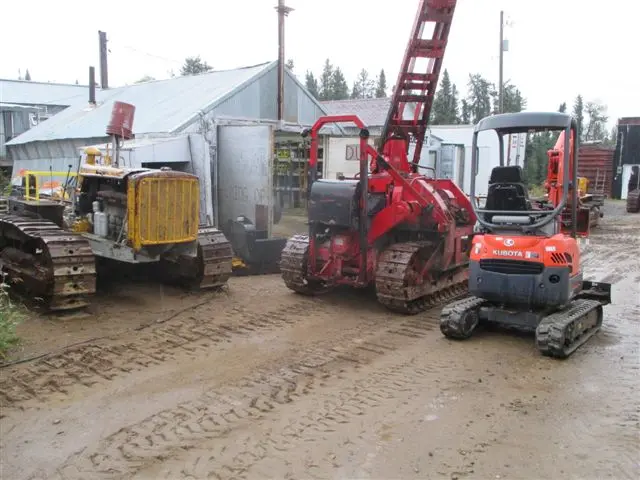

today i was moving cats around the Kingdom and got a picture of my first red crane cat i bought in 1987 with my mini "hoe" bought in 2017 plus the D6 9U known as The Bismark which i "aquired" in 2003.

That's a pretty diverse bunch. Still amazed by the Bismarck

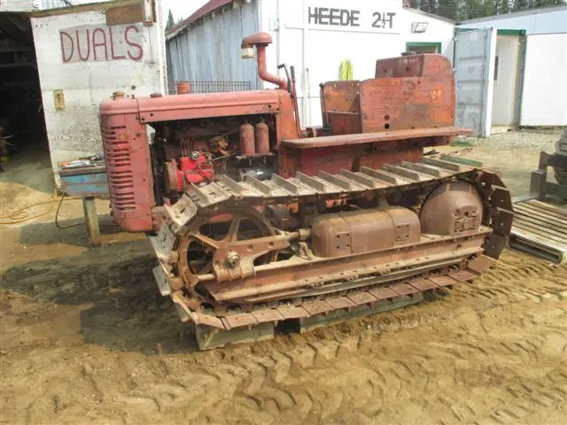

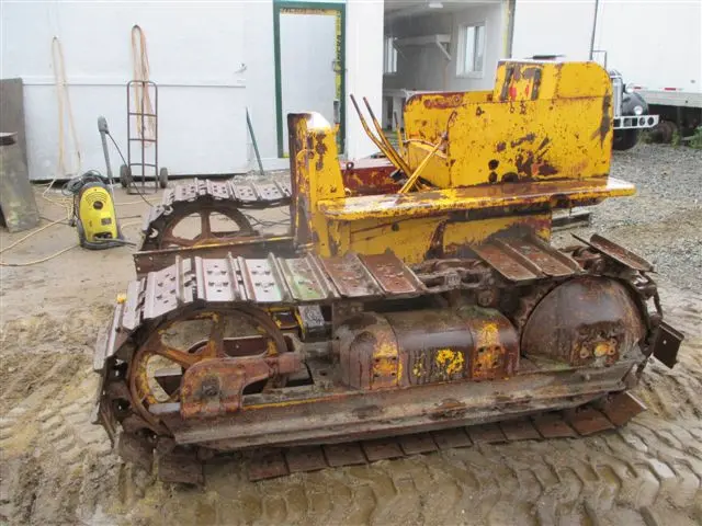

thansk guys, we finally got some rain after the heat wave for the last week. today i started working on the yellow td-9 imported from a far away land which is in better shape then the td-9 which i paid a lot of money thinking it was in good shape. never judge a book by it cover.
red cat-- 2 broken gears in trans, crown and pinion chunks missing, steering clutched are junk-worn out and not even salvagable, track chains are cracked out plus the cat was dropped 150 feet though the ice and landed on a rock which shoved the track arm into the tub and bent the crown gear hub, both final drives were toast but fixable since the mechanic put the bearing housing in the wrong sides which blocked off the oil passages. i guess he didn't know there is left and rights.
yellow cat -- trans good and nice gears, crown and pinion no pits or rust, one steering clutch is rusted due to mouse nest, track chain are useable for snow, tub and frame rails are very good. final drives look and feel ok.

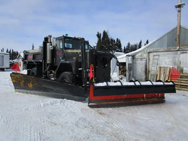

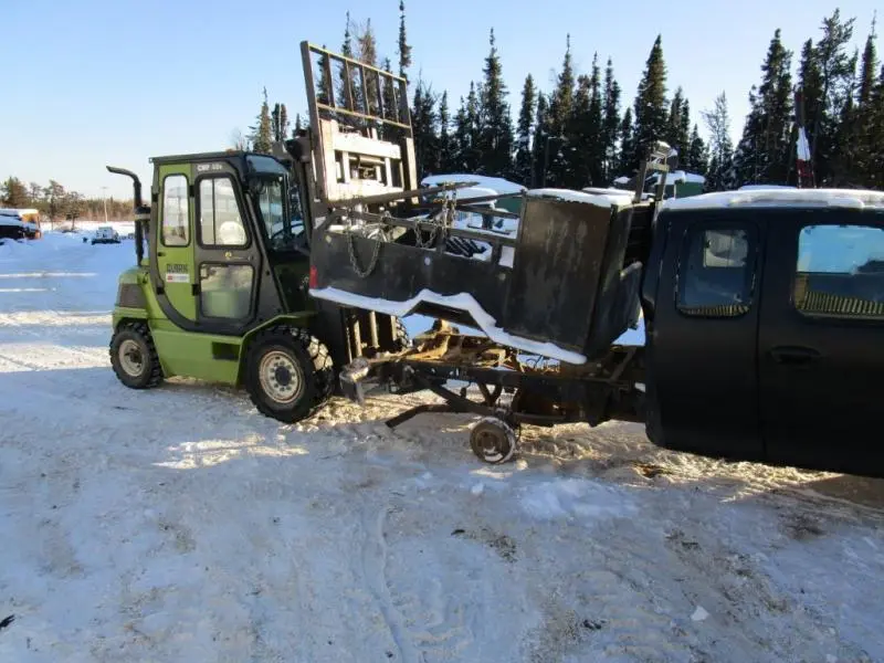

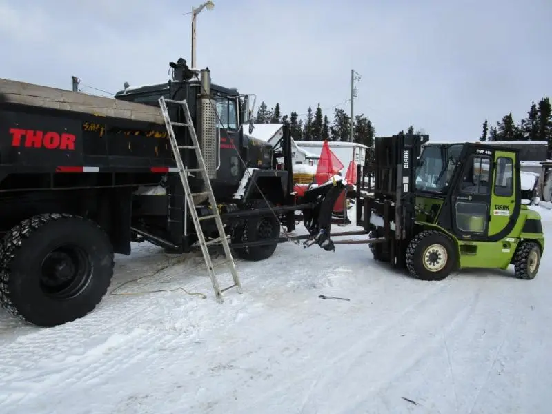

yes i'm here. just been busy making a living to afford my new toys. i bought a plow truck and a new forlift to make my life easier at my age.

OOOOOOH!!!! Sweet!!!!!!! Cat engine in the Oshkosh??? 1693?

OOOOOOH!!!! Sweet!!!!!!! Cat engine in the Oshkosh??? 1693? Maybe thats not a kosh bye gosh!

1983 IH paystar 5000 with 290 cummins and it is air force speced. one heavy duty truck which we have had a lot of fun with since it arrived int he Kingdom in january.
i wanted hevay duty but not looking military so buy from the air force instead.
