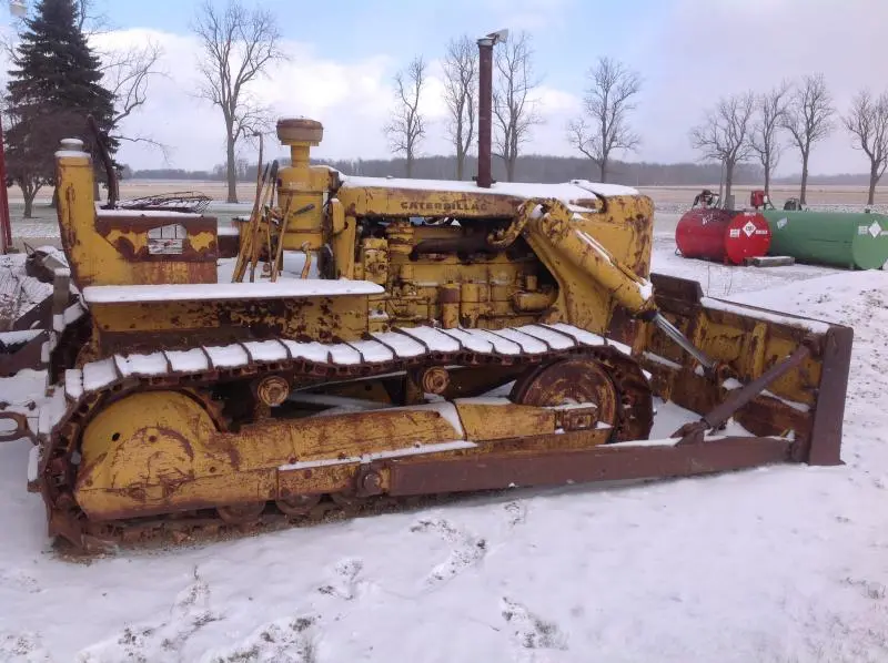

I just purchased my first Cat, a D6-9U serial number 9U27224. This dozer was purchased new to clear fence rows by a well off farmer. Long story short the dozer was used to clear the needed fence rows and then parked in the barn. In the mid 80's the farm was sold with the equipment and the new owners used the dozer again to do a little fence row clearing before parking the dozer outside. I just purchased the dozer in hopes that I can get it running and use it to clear fence rows myself. What I have noticed so far is that the hour meter on the injection pump reads 0079, the track adjusters are all the way in (track not very loose), grousers are more then 2 inches deep, and the undercarriage shows very little wear to the untrained eye. Now I don't believe that the hours are accurate, but all accounts suggest that the dozer has less then 500 original hours. My questions are as follows:
It has been 7 years since the dozer was last used, should the track be lubed prior to attempting to move it? Is there anything else about the power train I need to be looking at prior to attempting to move the machine? I intend to change the oil in the pony and drain any water off the bottom of the transmission, clutch, and engine housings. Unfortunately I need it running to get onto the truck to get it home and its current location doesn't allow me change fluids or go to great lengths.
The pony motor is free but I'm sure the carburetor is going to need attention, it sounds like the carb may be the same as Deere used on their pony motors can any one confirm this?
Does this machine call for a 6 volt or 12 volt battery?
If I am able to get the machine running and moving properly do the low hours make it more valuable as a collectors piece or do I go ahead and put it back to work? I really have no idea what the machine is worth if functional.
Any information or suggestions would be greatly appreciated.

That's a nice D6. Congrats on your new acquisition. The start of an addiction! I wouldn't think you would need to lube the tracks; if you have another tractor, pull it and see if she rolls freely; if not, then it's obvious. As far as the rest, make sure everything moves freely as well and check /top off fluid levels. 6 volt for the pony, plenty of folks will use a 12 without issues; don't be surprised, with minor tinkering she'll most likely come to life from hibernation. Good luck. Juiceman.
Sun, Jun 28, 2015 10:13 AM
A couple other fluid checks that are important
Injection pump housing..fill with motor oil until it almost runs out the large plug on the side
Pony pinion clutch housing. Plugs on side to check, about 3/8 or 1/2" square head pipe thread plugs. Fill with engine oil or auto trans fluid....this oil lubes the pony camshaft gear, idler, mag drive gear etc as well as the pony pinion clutch, brake and bearings.
Steering hydraulic assist booster....large hex socket plug under rear of the seat.....can be tight getting to it if you have a rear double drum CCU mounted. Fill with motor oil or hydraulic oil until it runs out the plug hole. You can steer the tractor without this one, but it won't be easy to pull the steering clutch levers. When it leaks out it goes into the bevel gear/transmission compartment, leaving no trace.
If your tracks are frozen solid and cannot be rolled, soaking with water sometimes helps or build a fire and shovel coals onto them to heat them up.
Carb is a zenith TU4C also used on JD pony start Diesels. Partial rebuild Kit available from JD parts. Or look up a Zenith dealer or CAT services individual parts still i believe.

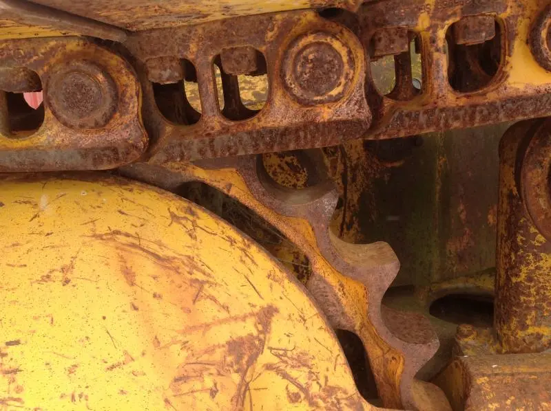

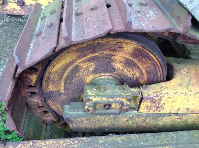

Just from looking at the few pictures it looks like the original paint and the undercarriage looks like new. There's not even any dents in the guards over the tensioner.
Nice tractor, Randy
Nice tractor, Randy
Looks like a nice one. There are a lot of 9U's running good so I don't see many people wanting to pay big for a original parts good machine,but I have been wrong before. Post it on the for sale here when you get it running and see if any want it. With the parked in the barn was expecting the paint to be some better than picture.
Hopefully the fuel tank was filled before the long nap.I picked up a 9U that hadn't run since the 90's parked in a barn in a near dessert and the fuel tank was very bad rusted.The old fuel burned well never dumped any of it but gave up and used a different fuel tank.
If you have a 12 volt battery you can borrow,us that to test and get you home. CCJersey was has covered most things well,except the wet clutch should also be checked for water and topped off.
