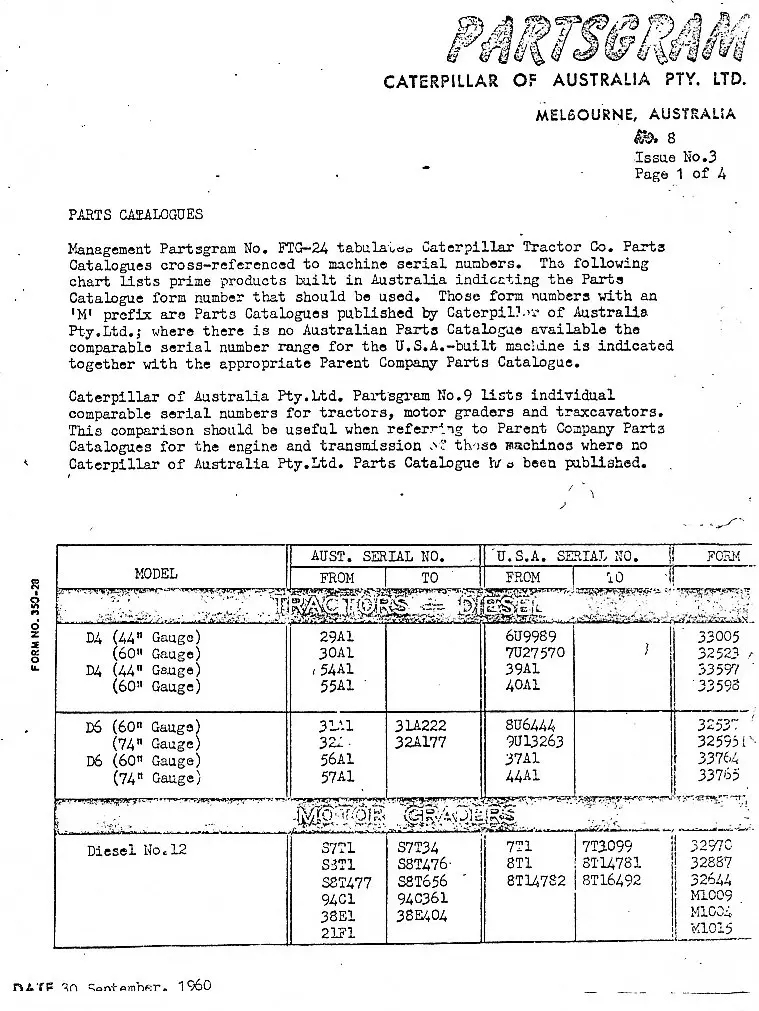

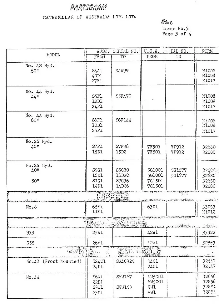

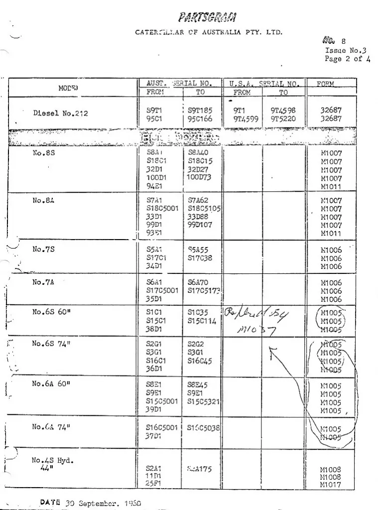

Hi Clint,
your 29A 0092 D4 is the equivalent to a D4 S/No 6U12466. So all you need to get is the relevant Service manuals for this S/No range of 6U machines. There were OZ manuals/books for the 29A but they were/are few and far between. This data from my Cat records of OZ built D4 tractors.
The machines were imported here as a skid pack less all undercarriage.
The track frames, rollers, idlers, tracks and blades, hyd. controls, cylinders, rippers etc made here for them. The "S" prefix on some S/No's designates that a local Company "Steelweld" built the products under licence here in Melbourne.
Scanned below is the Cat of Australia Form No's for the Parts Books for most of the OZ built machines of the day. Grab 'em while they are up, even if out of order as per usual !!!!
Hope this helps.
