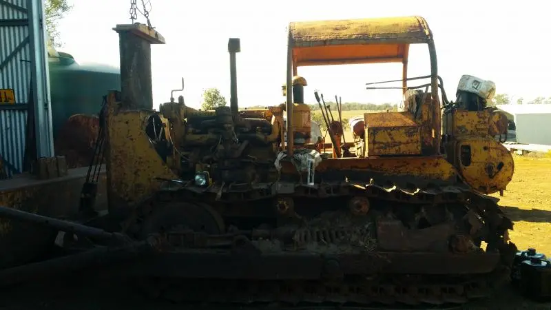

I just bought an old military D7 dozer, serial number 75E681, I'd like to know the year?? Also the radiator is leaking from possibly rust, how do I remove the radiator, do I need to take the nose off? Anyone have any advice to finding the cheapest core for the radiator?

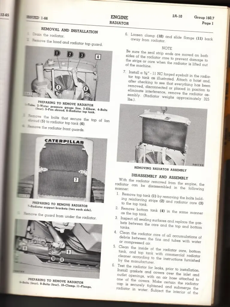

Nose does not need to come off.Radiator comes out the top.Just need strong enough lifting device that will go high enough to clear tractor.Actually pretty simple to get out.

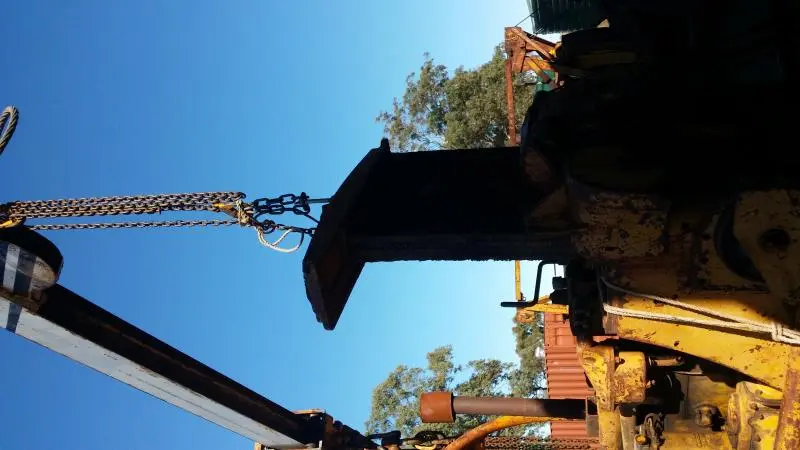

Removing a radiator from a 3T . Your tractor will be similar to do this job.

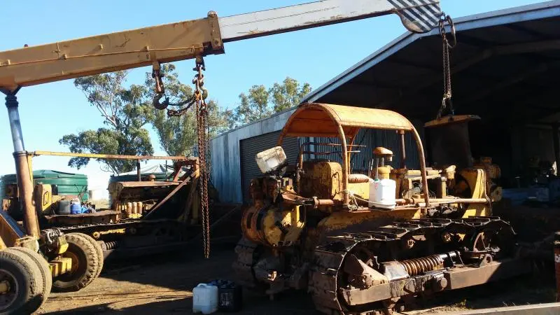

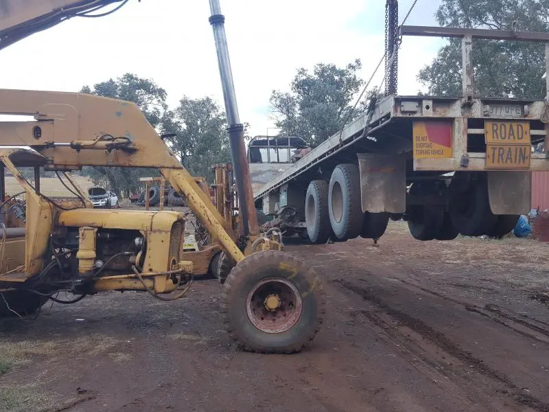

Andrew,that's a handy lift you have there.I can see lots of uses for it
Sat, Oct 20, 2018 7:46 AM
Andrew
Posts: 886
Reply to gary in CA:
Yeah thanks. Between the Chamberlain crane and the forklift I would be lost without them.
Certainly makes things easy.
Cranes like that can be cheap to purchase now due to work place safely issue's.
