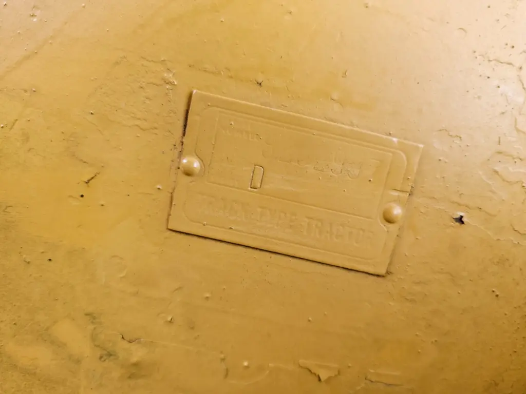

Tried to lookup parts on parts.cat.com and the said serial number was invalid. Can someone test out serial number 82J2997? Sorry about the paint but tha's how we bought it.  i'll see if I can clean up the plate a bit.
82J2997 is a good s/n. 1971 model with D330C engine.
Thanks for the reply Old Magnet. Glad to know that I have a valid number. CAT.com took a few hours to say it was valid but the parts site still says invalid.
Oh well, I guess after market parts for me now.
I'll get back on chat and find out why my SN says invalid. I need a hydraulic tank strainer (under the filler cap) now though and I have got a parts manual yet.
