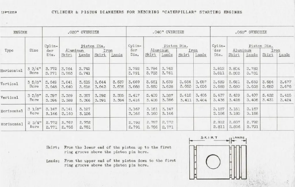

Here's the specs.... [attachment=61469]startingenginepiston (copy).JPG[/attachment]
i agree with Neil, those are pretty low tech pistons considering whats available today. A few measurements should be all it takes to find something suitable.
-Have you heard of J E pistons? made in California i believe, that's the first thing i thought of, then realized J P, which are Australian made. Both are excellent products. There's quite a few piston manufacturers out there, or there was, this is a difficult time for many business'
JP pistons are good stuff i had to order a piston for a BSA engine it came with rings, gudgeon pin and pin retainers. only took 2 weeks due to manufacture time. it fitted perfect. im sure if you sent them a copy of the spec sheet that OM posted they would be able to confirm it would fit and if not they may be able to make you a pair that will as all pistons are rough cast and then machined to size from a basic blank. or you could go billet aluminium and get a shop to turn up a couple for you.
as long as the crown to pivot centre is the same or slightly less(it would drop the compression slightly), the od is correct and pin size is correct it would work.
i seem to remember jp had the specs for the pistons they make on there website. they would provide them by request of course too.
