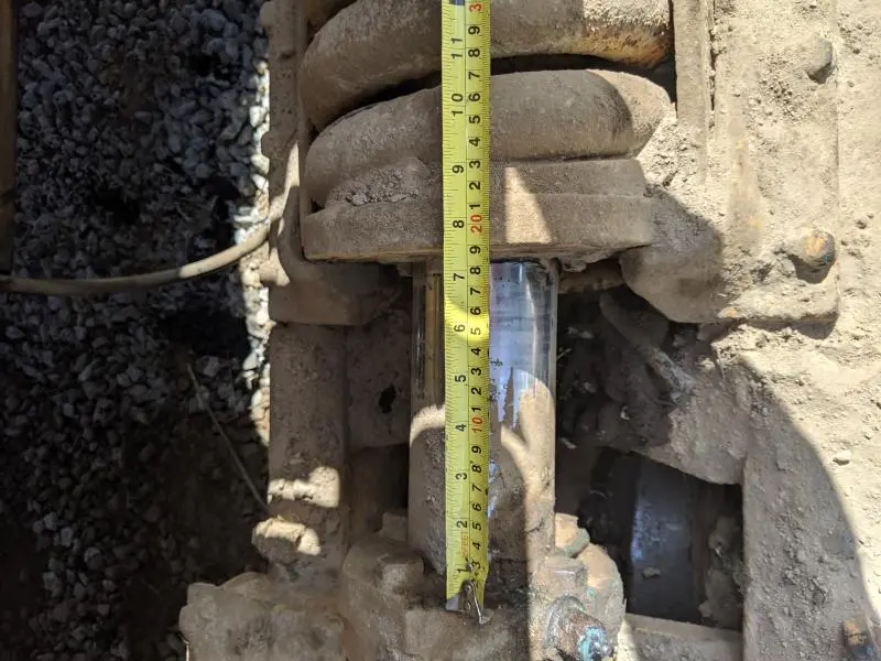

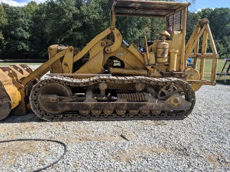

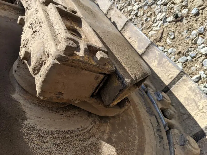

I can't get it to go any further with grease gun, before I try to add external help can anyone confirm/deny if it's at it's max?[attachment=55506]IMG_20191001_135845.jpg[/attachment][attachment=55507]IMG_20191001_135111.jpg[/attachment][attachment=55508]IMG_20191001_125917.jpg[/attachment]

"Whoa boy! thats about as far as ya gunna go"

O & M instructions for the 20A says 6-1/4" is maximum recommended extension.

lol, thanks
so I'm guessing I need a buddy that knows how/wants to remove a link? I found the master link it's welded into place

thank you for the spec on that the 53A1 and up manual was even less at 5 9/16 inch
