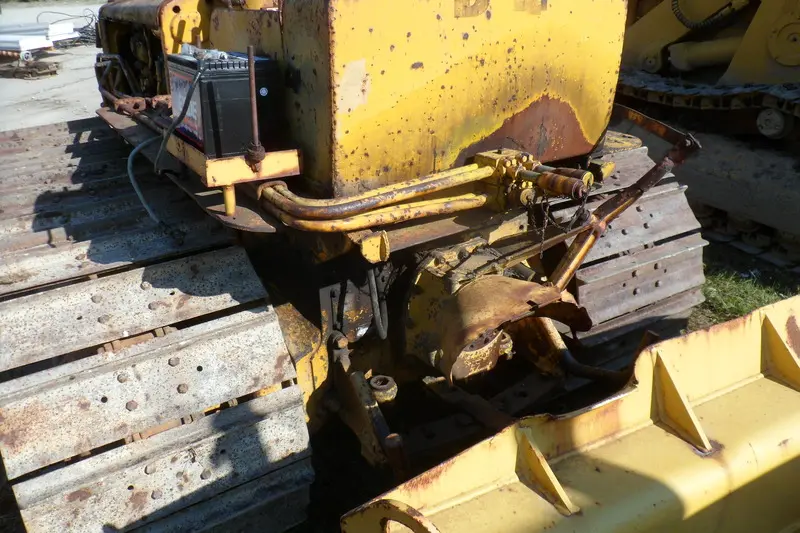

where is the fill hole for the final drives? I can see the drain fitting but on this machine there is a hole a couple inches above from the underneath but on my machine there are no plugs in them. Are those the fill holes?

the fill plugs for the final drives are on the rear of the lower part of the transmission case and can be checked without crawling under the machine

Hi, Budasterisk
You can see one of the final drive fill/level plugs in this photo, the cup-like fitting with the in-hex plug inside the drawbar support mount.
[attachment=51042]Cat D4 7U20888 crawler with 24-inch plates_1C_Acmoc.jpg[/attachment]
Just my 0.02. Hope it helps.
