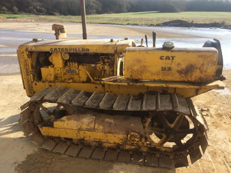

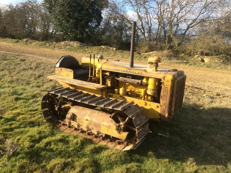

I bought a 5J D2 in May last year having always wanted some old iron but not really knowing a lot about them to be honest. Since then I’ve spent countless hours reading old posts on this forum and have learnt lots about my new toy so thanks for that already! The knowledge here on these old machines is amazing.
I’ve got reprints of the owners manual and parts books from Finnings UK and the D2 is in pretty good shape really although the pony needs rebuilding as the flywheel is doing the dance of death.
Anyway, I was under the D2 the other day and noticed that the small spring (4B9290) under the main equaliser spring is missing. Not sure how I haven’t noticed that before but never mind. I’m pretty keen to get it replaced, I don’t really want the tractor rearing up on me any time soon.
I’ve found a complete equaliser assembly but the guy selling thinks they are off a 5U.. the only number he has is 8B9370 off the transmission case. My 5J parts book shows transmission case as being 5B5693.. so I’m guessing he’s right and it’s off U series? So my question is are the small springs the same between J and U series? I suspect not but hoping as parts in the UK aren’t too easy to find.

The small spring, 4B9290 should be the same for all D2 models.
