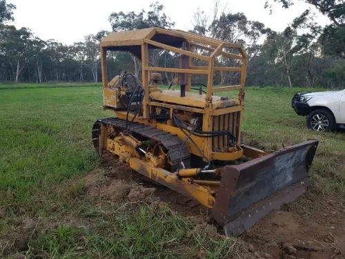

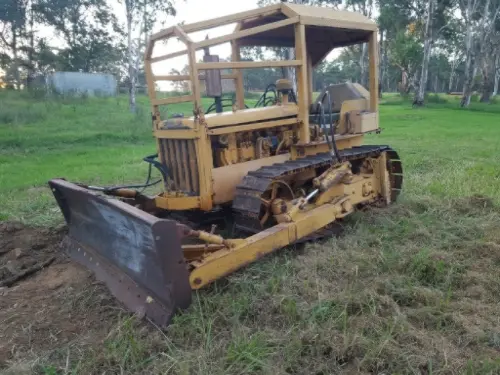

The unit itself is in quite good nick and was well looked after. Though the blade seems WAY to big and almost up ends the tractor, or at least to cantilevered.
