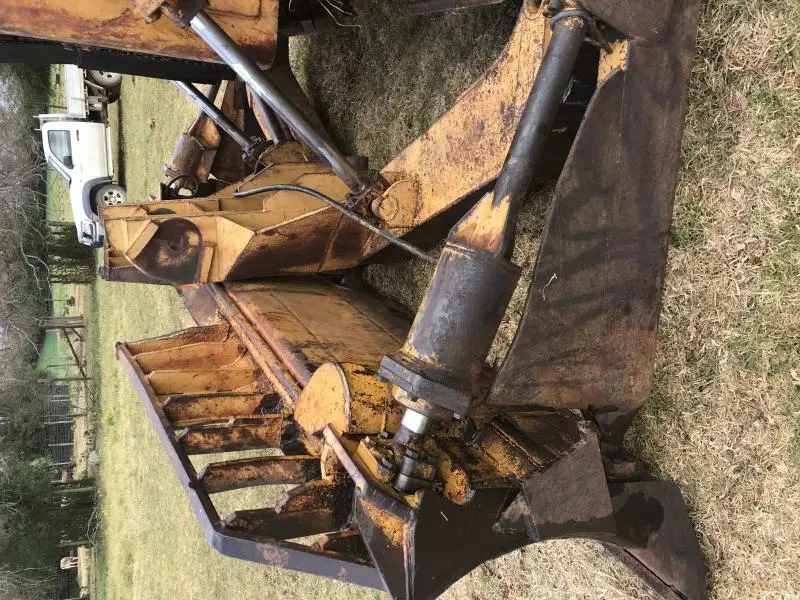

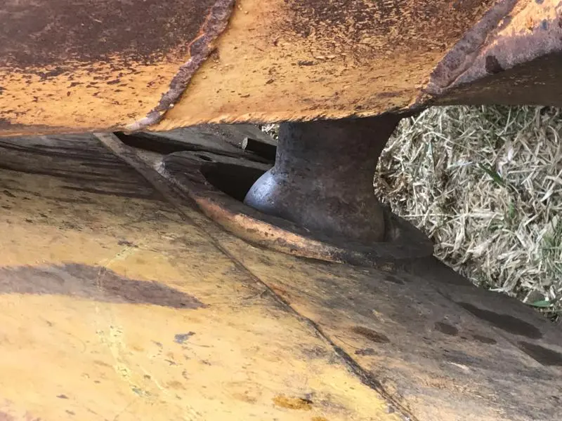

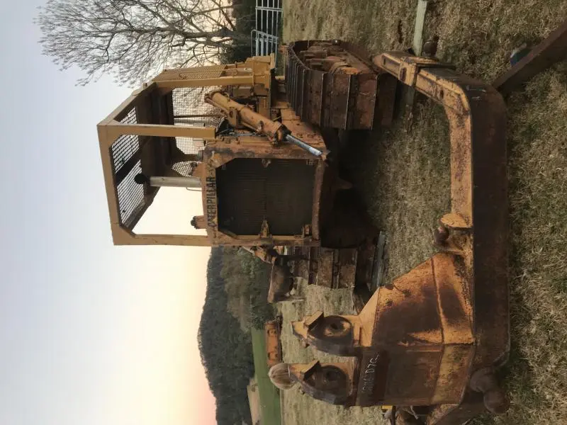

Hi guys, hoping someone can help.
I got an angle blade group from Tilly’s for my D7F. I’m fairly sure it’s not a Cat setup as it’s not like anything over ever seen on a Cat. The blade angles by moving pins with a sliding box section on the C-Frame.
Anyway, I need to identify it as I’m fairly sure it’s missing a cap or fitting of some sort for or two giant ball and socket type setup where the blade mounts to the frame.
If it’s any help in identifying it, it looks as though it’s had the hard lines to not just tilt the blade side to side but lean it forward and back as well (by moving both both tilt cylinders in the same direction)
Any info wouldn’t be appreciated. Thanks.

My guess is that you are missing a cup that sits in front of the ball and a two piece cap that then bolts to the blade to hold the ball in place.
Wombat
Seem to recall seeing that ball and socket arrangement on Fiat dozers.
Looks like fiat Allis Chalmers to me as well.
Maybe check the dimensions of the ball against those of a VPAT blade on a D6R, if you are in luck they maybe the same. Have you checked with Tilly's to see if they have the bits somewhere in their yard.
