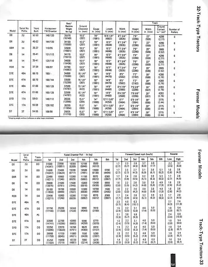

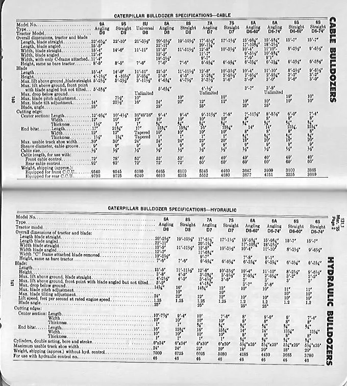

Posts: 4,090
Thank you received: 27
Reply to captainhowdy:
do you know the width of the straight blade? or the length of the unit with blade attached?
Hi CH,
Blade specs from my 1955 Earthmoving Guide For Profit Spec Book and may be specs for models before the 17A, which was released in 1955.
Tractor specs are from Performance Hand Book No 4, Former Models Section.
Hope they help -- overall length of combined units is included in the Blade Specs.
Sat, Apr 8, 2017 8:13 AM
captainhowdy
Send a private message to captainhowdy
Posts: 192
Reply to edb:
Hi CH,
Yes!! Thank You! that is the info i needed😄
