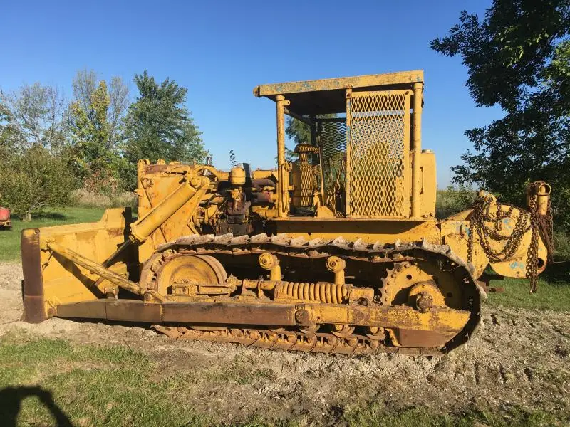

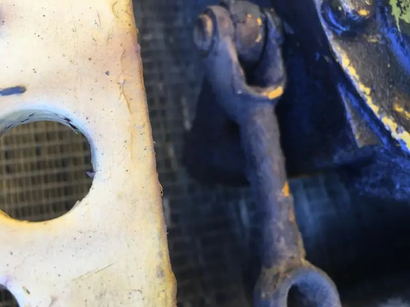

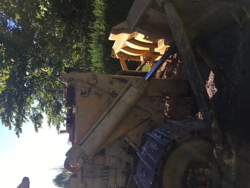

Hi I have a 1945 D74T on the reservoir it leaks just a little where the arm on the top rotates, haven’t found anything else wrong is there a procedure to bleed the air out or a filter that needs replaced? It raises the blade up but the blade won’t stay up it slowly goes down it will lift the front of the crawler up and hold it for awhile any thoughts are much appreciated thank you

What you described with the blade bleeding down tells me first thing i would do is rebuild the cylinders. This can be done yourself easily. You should have a local seal house that can order you the correct seals. Just pull one of your cylinders apart pull all of the seals and take them to them.
