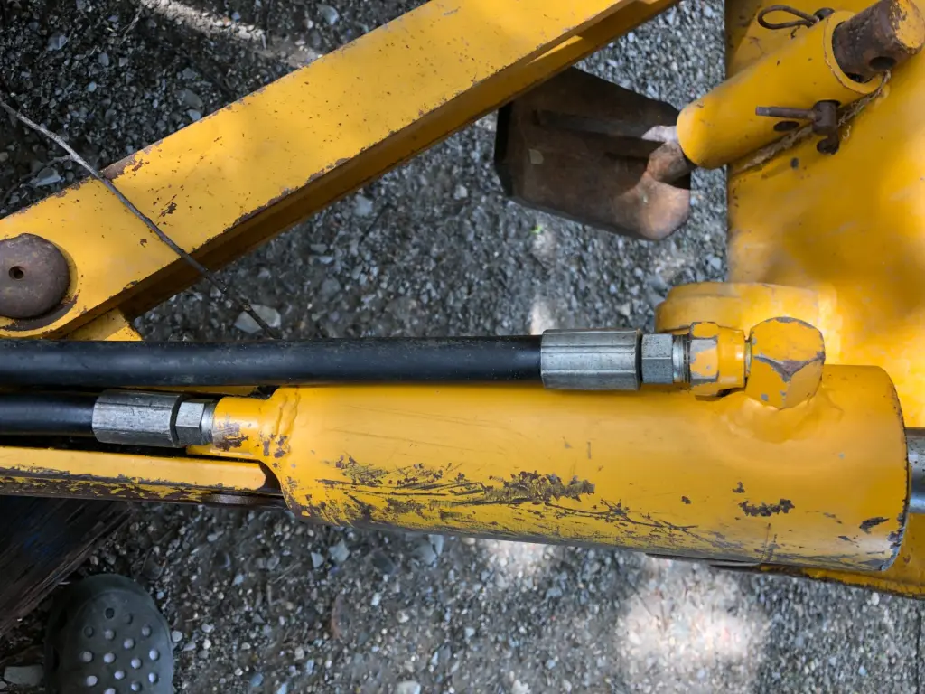

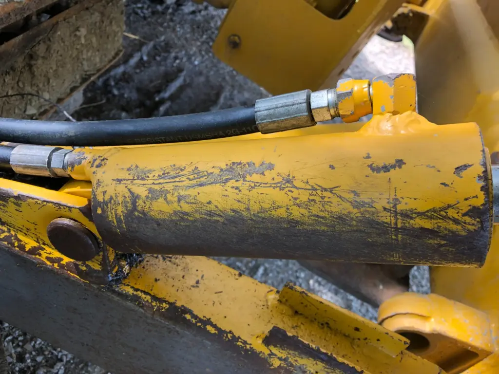

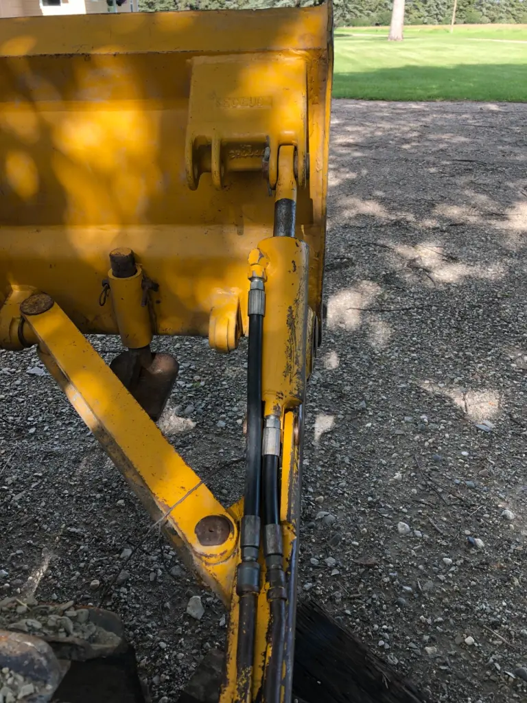

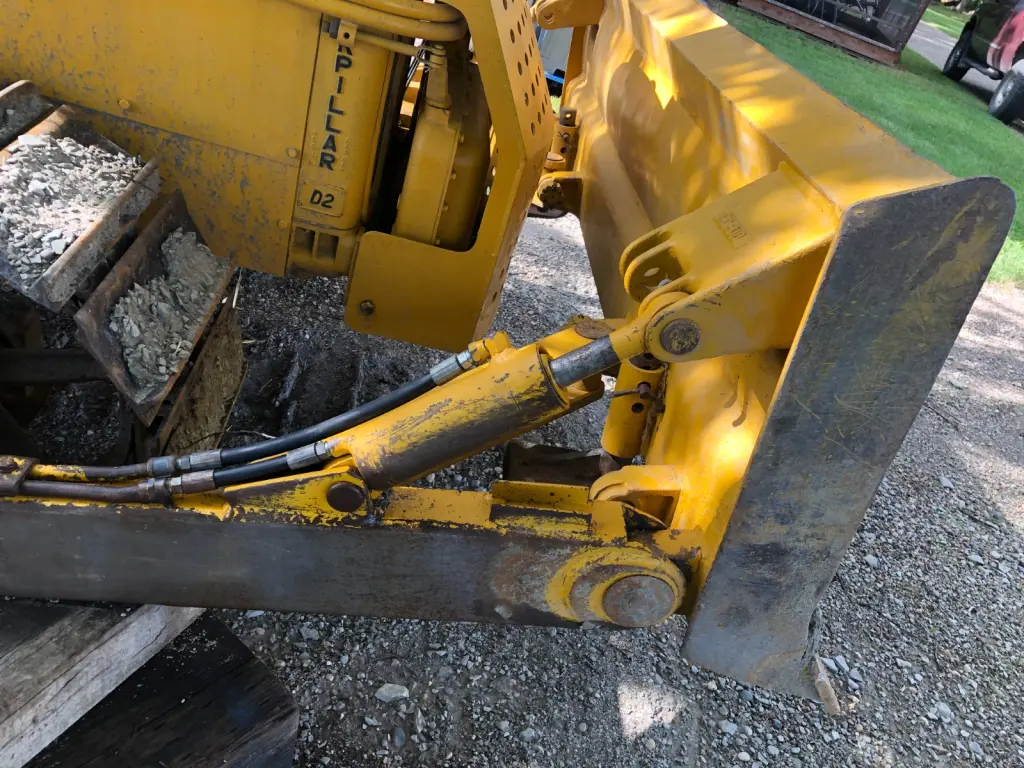

Looking for part numbers for dozer tilt cylinders.  preferably part numbers for individual parts.  First though I think I need to indentify the part number for the cylinder I have.
I could not find any part numbers on the cylinder itself.  I have attached some pictures of it.
Can any one identify it, or give me a list of possible Cat Part Nos. [attachment=62751]IMG_1510.JPG[/attachment][attachment=62752]IMG_1509.JPG[/attachment][attachment=62753]IMG_1511.JPG[/attachment][attachment=62754]IMG_1507.JPG[/attachment][attachment=62755]IMG_1508.JPG[/attachment]

Well, I know that cylinder might not be found in a D2 or D2 attachment parts catalog. Pretty sure the toolbar arrangement didn't include a tilt cylinder. Any chance of asking the previous owner?

That is an after market cylinder. As Neil stated there were no Cat tilt cylinders for a Cat tool bar dozer. I made a tilt cylinder for my tool bar dozer from a cylinder off of a fork lift boom tilt cylinder. You might have to take it to a local hydraulic shop to find parts.

Pretty cool though, and that is a super tidy arrangement for the host connections - I like tidy, clean installations like that - it just about could have been OEM except Cat would have had some clunky hose arrangement instead

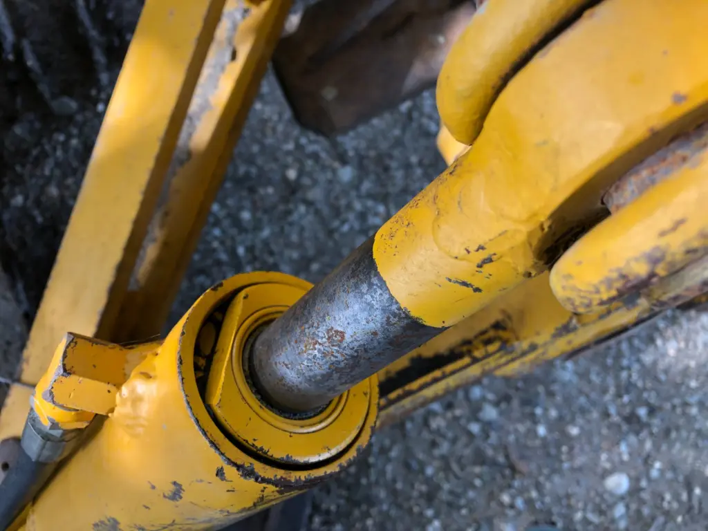

I kind of figured it was either home made, or aftermarket as Cat always put part numbers on everything. Has an odd C-clip partly hidden behind the end housing which needs to be released as you pull the housing end out. Having a hard job getting it out, perhaps the housing is getting stuck on rust. letting it soak for a few days.

You might have to drive the end housing in a little to get the C clip out.

Unfortunately the C clip won't come out without the end housing coming with it. If you notice the kind of D shape to the end housing, that is where you can get the tool in the holes to collapse the C clip, but it won't come out as there is about an inch of housing in the way. I can try driving the housing in a bit to see if that loosens things up, so far I have been just using the plunger as kind of a slide hammer to work it out, but only moves about 1/4 inch. Hard to manage with one person, but I will keep at it.
It is weird, usually the C clip is right on the outside.

the housing came out pretty easy after soaking in penetrating oil for a few days. Just sprayed some around the housing and let it sit.
