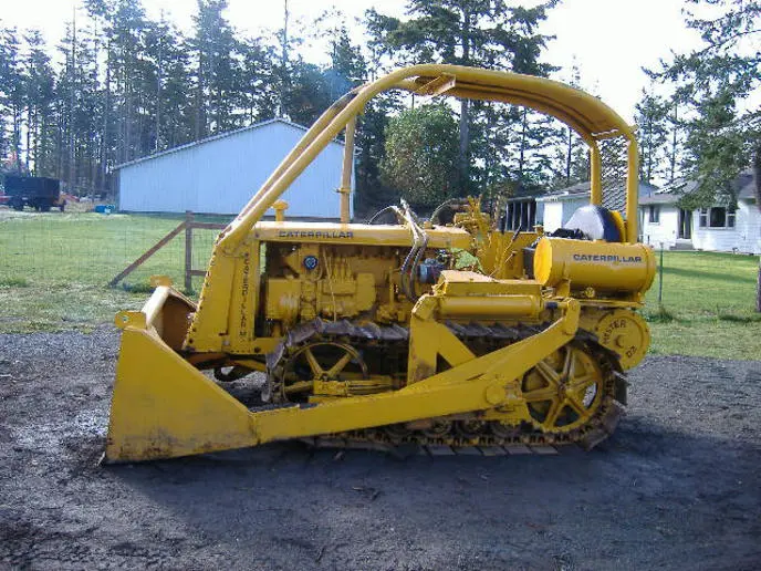

Interesting you bring that up, it's something I never really thought about myself until seeing first hand the difference between the Cat 2A blade on my dad's D2 and the 2S blade on my D2. Since the 2A blade is intended to angle, of course then the center of the C frame will have to stand out farther in front of the hydraulic unit to permit the blade to achieve full angle and still have clearance in front of the tracks. Naturally, a down side of that situation is a blade that's a lot farther out in front of the tractor when it's set straight. Also, as a rule of thumb angle blades will always be wider than straight blades because when they're placed at their max. angle they still need to be just as wide as the machine (which I'm sure is already a well known fact here but since we're on the topic anyway), further compounding the nose heavy problem. For reference, take a look at the distance between the grill guard and the blade and C frame of the 2A setup in this picture-
[img]http://i802.photobucket.com/albums/yy310/TRNelson/photo23_zpsc17dae96.jpg[/img]
Then notice how the non adjustable 2S blade sits right in tight in front of the same grill guard on my D2 - this clearance looks about right to me, no wasted space, just enough to permit adequate travel without binding on anything.
[img]http://i802.photobucket.com/albums/yy310/TRNelson/photo22_zpsdca15b7d.jpg[/img]
But at the end of the day, a D2 is just so short that it'll always feel nose-heavy to some extent even with larger front idlers, although they do help. And as far as the hydraulic cylinder travel direction versus lifting/lowering, I think Stephen pretty much hit the nail on the head. A lot of the LaPlante/Choate blade mechanisms on the D2's also operated in reverse of the Cat units, like the one pictured below.
