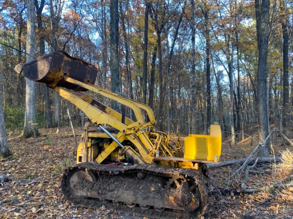

 [attachment=65292]89CAC662-897E-4F4C-A412-A108F1C1DFE3.jpeg[/attachment]
Got my D4 7U up and moving! The bucket is in rough shape (many farm repairs) and I’d like to add teeth. I found a toothed bucket an hour away for a 955 12u. Does anyone have any good pictures of an early 955 bucket? I’m wondering how far off the brackets are.
thanks.

see if you can get the tooth holders that bolt on. the cutting edge should be bolt on. the bucket itself should only be mild steel and you could drill it even cutting edge can be drilled with the right drills and lubrication and of course time.
