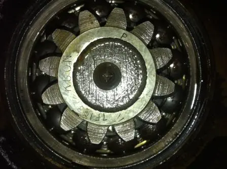

about to replace the bevel gear on my d4 with a second hand one from a fellow acmoc member.since it is coming form america
to australia, postage is not going to be cheap. i was wondering if you could take a look at the attached photo and let me know how worn you think the bevel pinion gear is,
and if i can get away with not removing and replacing it. I will probable have about 300 hours work at the absolute max to do on the dozer pushing dirt before it will be retired and used mabe once every 6 months to tidy up a drain etc.
what do you reckon ?
leave it be , or replace it so the bevel and pinion is a matching set that came out of another machine
thanks.

The generally accepted procedure is to replace rings and pinions in sets. Even if the wear on your pinion isn't severe, it won't be the same wear pattern established on the replaced ring gear (bevel gear). The result is wear in small spots rather than over the entire area of the gear teeth and thus very rapid wear and threat of easy breakage of teeth.
Does a Cat enjoy a greater leniency here than vehicle drive axles? I would guess not, but maybe. Better check with the greater experience than mine before you try it.

Is that a crack running from one tooth to the other or a piece of hair or something?

Reply to D4D83J:
thats just a bit of hair or string or something mate.
yes matching gears is what i thought.
though Im not overly concerned with tearing it back down again as its only a days work should the pinion break a tooth.
what i am more concerned about is the amount of wear on it.
i haven seen a new pinion gear so its hard for me to work out the wear.
also , when looking at the bevel gear, i believe the alignment was out as the wear is on the edge of the teeth.....
this i guess would also reflect on the pinion gear.
Thu, Dec 8, 2011 11:39 AM

Reply to callan:
also who is KUON ? as its stamped on the pinion. is this the original supplier or has the pinion been replaced with an aftermarket item
it has the original cat part number on it.
just a curiosity. also gives you another angle to inspect wear.

Reply to callan:
also one last thing in regards to wear jack , the pinion will not wear certain teeth of the bevel out as its contact pattern differs every rotation.
i.e pinion gear 12 tooth , bevel gear 53 tooth. for the first revolution the first tooth on the pinion gear will touch the 1st,13th,25th,37th and 49th tooth of the bevel gear
on the second revolution it will touch the 8th ,19th 31st and 43rd tooth.
see how it keeps rotating around the gear teeth. Gear manufacturers do this on purpose to promote an even wear rate.

Reply to callan:
To me that pinion doesn't look all that bad....seen a lot worse still operating. I don't see any chunks missing or severe wear but then I'm just looking at a picture.
Yes, pinions and bevel gears should be replaced in sets but in the bush that didn't always happen. For your limited use there seems to be plenty of life left, just do the best adjustment matching you can and don't go trying to push start any D8's.

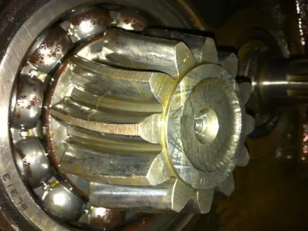

I'm glad this has come up, I was concerned about my pinion shaft as well (also D4), but found the pinion bearings were shot, have replaced them but wonder whether the pinion has taken a worn "set", now with new bearings potentially the tooth engage pattern will be different.
[img]http://i16.photobucket.com/albums/b1/RichardJayW1/pinion.jpg[/img]
I showed your photo to one of the best field Cat Mechanics in Oz and he feels for what you want to do it should be OK as the hard facing is worn a bit, but you need to be sure that pinion shaft bearing is OK, the rust on the cage is one to look at carefully as there is enormous load there.
We just installed a "new" secondhand pinion shaft and crown wheel in my D4 7J yesterday, though be careful if you decide to replace that pinion bearing BL313, as I discovered our #1 aftermarket supplier of bearings here in Oz supplies lightweight bearings with only 8 balls, and not the original spec 12 balls found in my BL312 (P/N 1B4122), and no doubt your BL313. I just went out and bought a 12 ball bearing replacement bearing yesterday for the 8 ball replacement bearing I got from Qld., $192 thankyou very much. Those letters indicate it is a aftermarket pinion shaft. I got my pinion and crown wheel from Paul Moore in Toowoomba, he is a good guy to deal with and freight on heavy items is cheaper.
regards
Mike
Its a matter of opinion, but I would put those pinions back providing there are no chunks out of them, make sure you use the original shims under the bearing cage to keep them in the same position and set the backlash on the loose side to allow for wear, check tooth contact and, if necessary, loosen backlash a little more to get as good as possible contact pattern.
