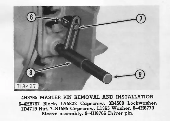

This info is from a later larger tractor but it shows how to deal with the sealed track pins.

Hi Phildirt,
no OM was not joking. He posted a pic of his "improved" version of Caterpillar's tooling to hold a pin punch for one man operation in the field.
The scan below is from the D7 17A SRB.
Sat, Aug 27, 2011 10:50 AM
