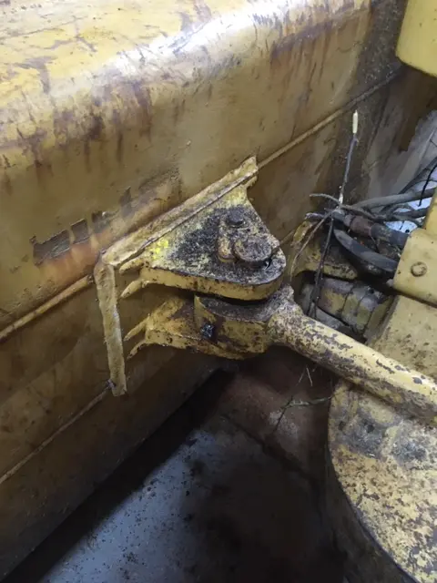

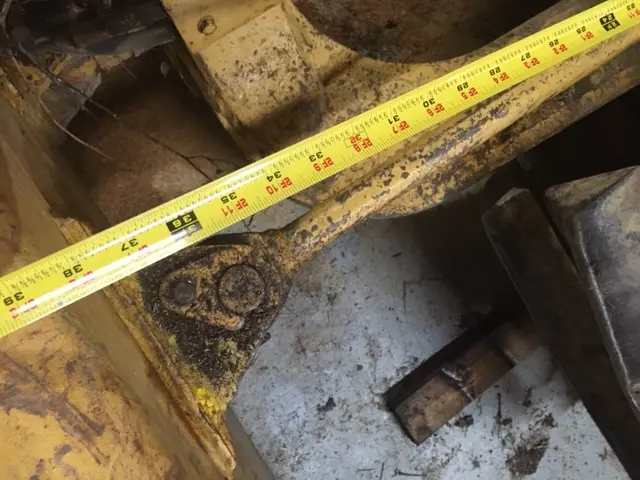

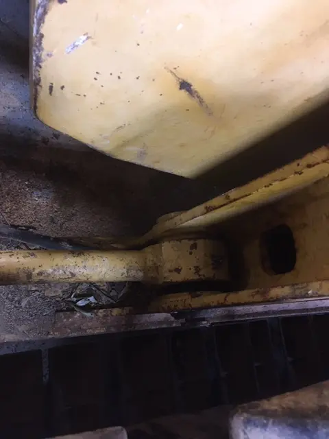

The photos attached should help to understand these struts on my D3B

I don't see how those struts adjust?? doesn't appear to be any screw threads?
are we talking about a vertical angle or a horizontal angle??

my guess would be to make your own arms
one longer and one shorter to replace those fixed length
or replace those with threaded arms

06Nxxxx is not a D3B, It is a D3 low ground pressure machine with straight blade and tilt only.

How about a picture of the top of the blade? Are you asking about blade pitch or blade angle? You may be able to adjust pitch but not angle.
That blade is not even close.

OK, looks like somebody substituted rigid rods in place of the normal 6-way blade angle cylinders.

I'd guess those rods came from the early straight blade arrangement.

Bmr---Nah--thats the standard hydraulic angle system
