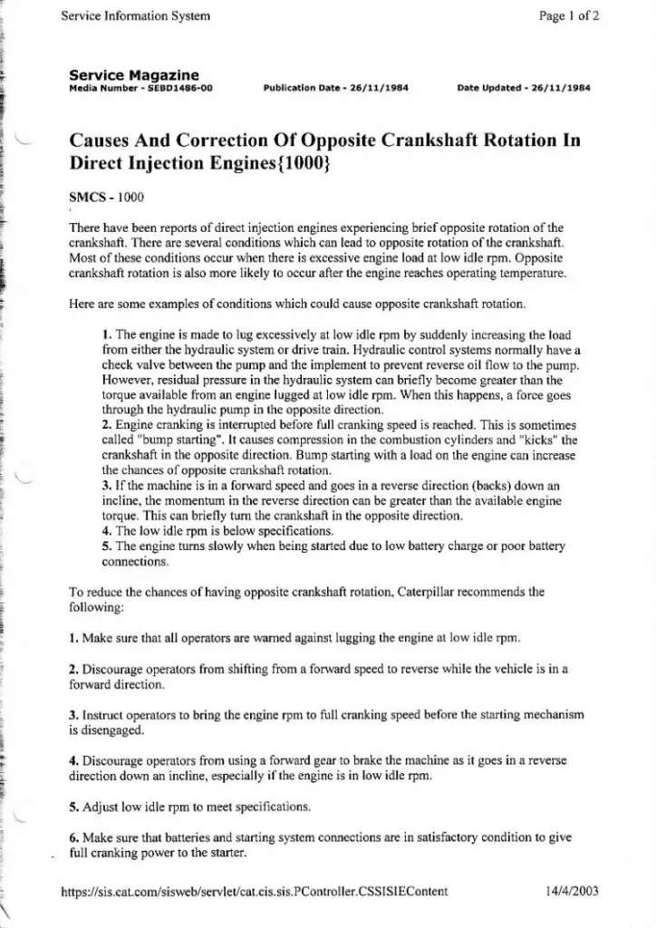

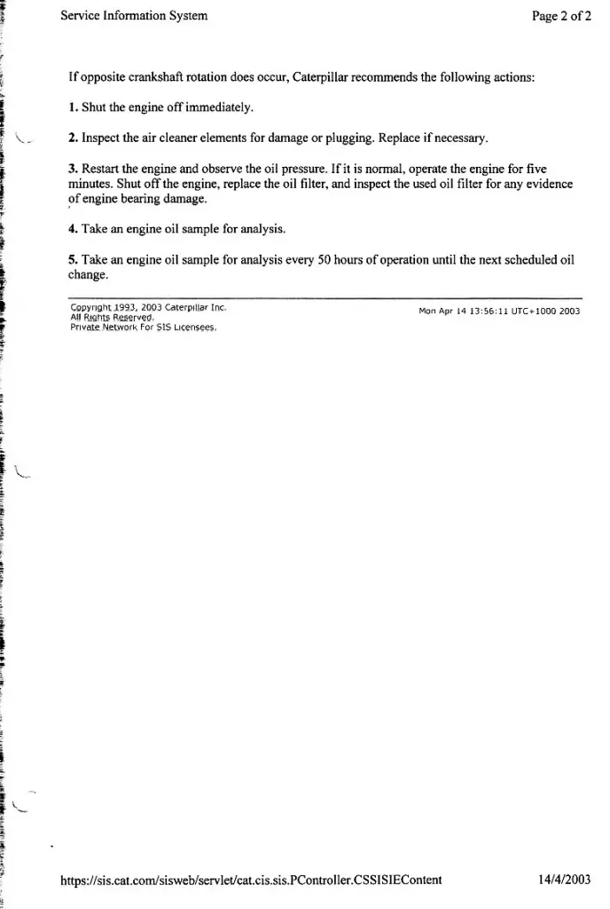

Had many G Series graders do this as I had the turbo's off them to fix as they had oil dripping from the inlet snail. The oil problem was caused by the soot blocking the inside of the air cleaner safety element and the resulting restricted inlet pressure drawing the oil into the inlet manifold, when they were re--started in the correct direction.
The operators usually said they never noticed the engine was running in rev--smoke caught by air cleaner element-- but that the engine restarted itself after not fully locking the foot pedal into the lock position after shut down and the hydraulic pump and system pressure turned the engine in reverse and it restarted.
I have run a Pre-comb. engine incorrectly timed 180~ out by a client--he was there for a dyno test after he did a rebuild on D330 engine also, and insisted it would go with "Start Ya B#$%^*d", a local engine ether start spray can, and at his risk HE squired said fluid in to the intake.
It ran poorly but did run from excess residual fuel in the cylinders dieseling.
Did know of at least one engine needing full re-build after running in rev. whilst the operator refueled and, said "blow it" after the engine restarted as he left the cab. He only shut it down when he heard the engine knocking from failed bearings.
Was mainly a problem with the New Scroll Injection pumps as fitted to the DI 3304/6 etc.
They came out with a redesigned cam shape to stop this occuring.
Scan below is a Service Letter on this problem.
Your explaination of the events leading to your engine re-starting in reverse rotation is what I also could agree to as the sequence of events to cause such a condition to occur.
