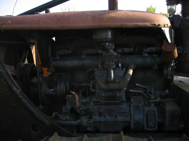

I'm going to try to get diesel onto the pistons in the next few weeks and let it sit a few weeks. Sounds like I should drain the pan and watch for diesel down below. I've also heard of the coke solution (it contains a mild acid), but it seems that in a fairly short time the acid will neutralize and leave water+sugar in the cylinders/crankcase. I'm afraid the water would end up doing more damage if not removed. I might try this after the diesel on an overnight basis.
Since the intake comes from the bottom (see photo), it looks easiest to direct it in through the exhaust, pulling the valve covers and opening the exhaust valves. This also offers the opportunity to inpect the rockers, etc and assess the damages. I'll also drop the transfer pump and check it out.

Reply to mccsl:
[attachment=7379]D7 Intake.jpg[/attachment]
