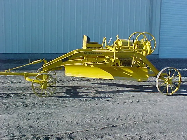

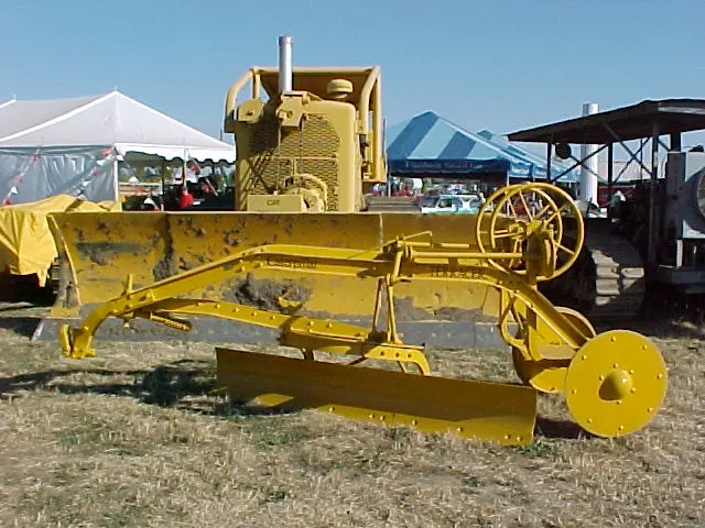

Here what you have if its a Cat or it could be this non Cat grader then a Cat terracer
