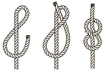

Hi Team,
seeing Sasquatch's starter rope with a normal land lubbers Overhand Knot that can slip at anytime with possible hurtful results.
I suggest using a Figure Of Eight Knot for Safety Reasons--less liable to slip.
Scan below shows how to tie a Figure Of Eight Knot.

Reply to edb:
Hi Team,
Thanks, Eddie-
I was just looking at the parts book & trying to guess the length of that rope for the D2...hard to tell from the pic...
I wonder if the handle is still available from Cat...rope is no problem at the hardware store.
Sat, Sep 27, 2014 8:54 AM
