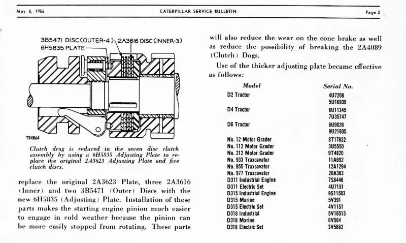

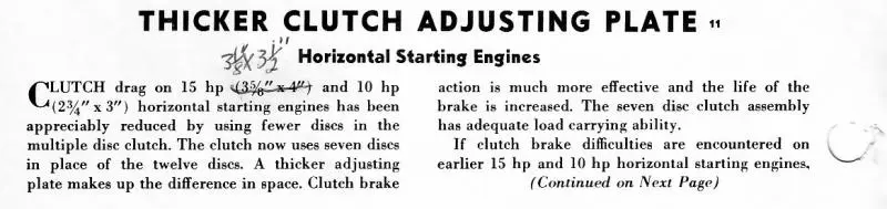

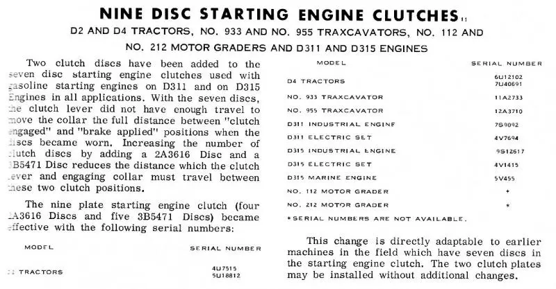

Hi Team,
came across this data whilst searching my literature for something else.
It may help some of us understand why some machines experience clutch drag and others do not.
Cat came out with updates to the Horizontal Pony Engine clutches. This info is scanned below from Service Bulletin-engines May 08-1956.
Similar updates were done for Vertical units but there are some upgrades and supplimentry info to sift as yet. I will post this when I am happy with the data being correct.

The first one state they add two discs and the second one states they decreased the number of discs?

The way I read that is the second series was the original update and the first one was the second update, that's the way I see it by s/n anyway.
Thanks for posting those Eddie
Hi Team,
YES, the first scan is the up-date/supplement to the original two scans I posted. This BB can load scans as it sees fit. BUT, to be fair, I did add the now first scan later on.
