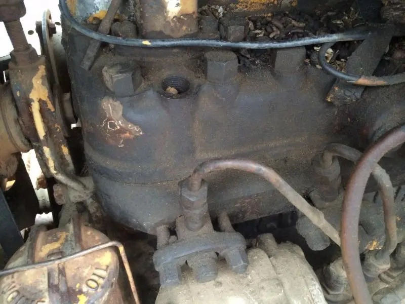

We were doing a paving Job in the mountain community of Painted Cave near Santa Barbara California when I came across this machine. The owner wanted it gone so I added it to my collection. Any ideas why a Cletrac would have a Holt blade? Maybe taken off earlier machine? I am not sure what model the Cletrac is. It has a Hercules diesel. Injectors go into side of block. it has an open threaded port in the head for each cylinder that I do not know what it is for. machine has not run in 30 years and dead axle is broken but owner had a spare he gave me.

Looks like BD model, four cylinder? I believe the ports may have been for spark plugs for gas engine. The blade looks like it was made for the tractor. Nice little tractor. I have a 1950 BGS, gas engine, bare tractor with pto.

Pete, are you sure that's a diesel? The injectors(?) are too far down in the cyl and the injector lines seem to big to support the high pressure of diesel injection.

Yes it is a 4 cylinder diesel, Bosch injector pump with Timken governor 2 battery boxes but not sure if it was 24v or 12v.

There is a shot of the engine with injector pump. I need to study the engine some more but it is strange the injectors go I. Side of block. There mustne a port to a precombustion chamber in the head possibly??

Those look like Ricardo-style injectors / pre combustion chambers - well-known in English circles. Nice unit with an OEM-looking blade and PTO. Looking forward to the video of the first start! : )

Yes, it's a Diesel. that's a Lanova head, also used by Buda, & called Buda-Lanova. I believe Waukesha used it on some engines too...
The injector sprays across the top of the piston into a precombustion chamber on the other side.
the threaded holes I have no idea on...I've seen a couple Oliver crawlers with Herc engine, but don't remember that.
