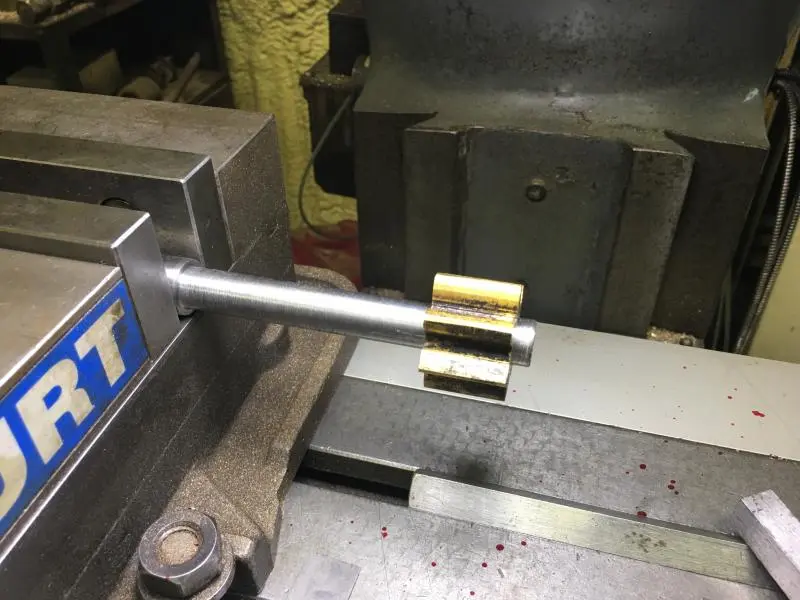

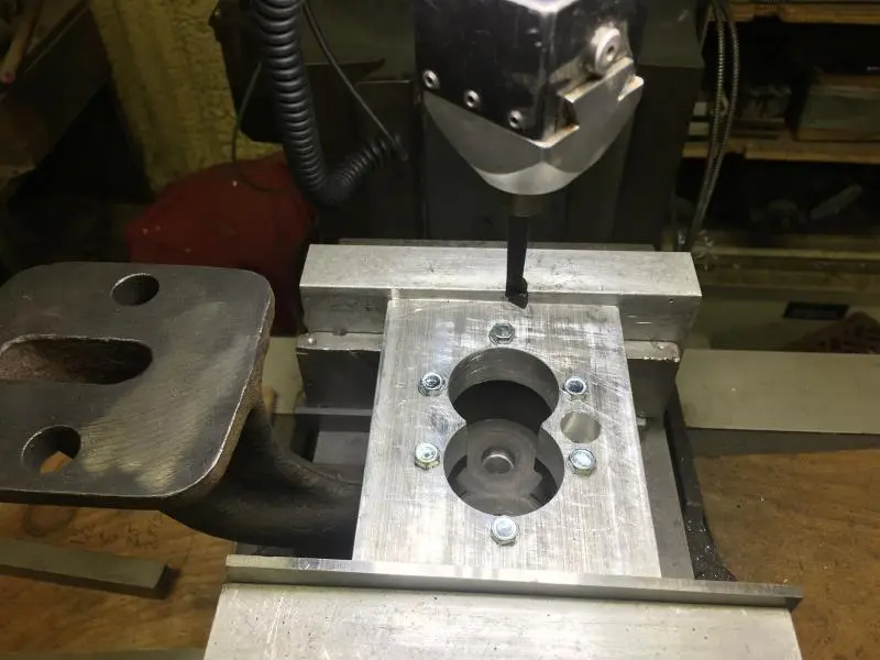

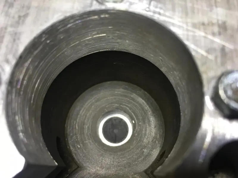

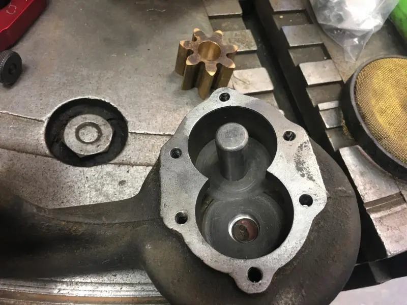

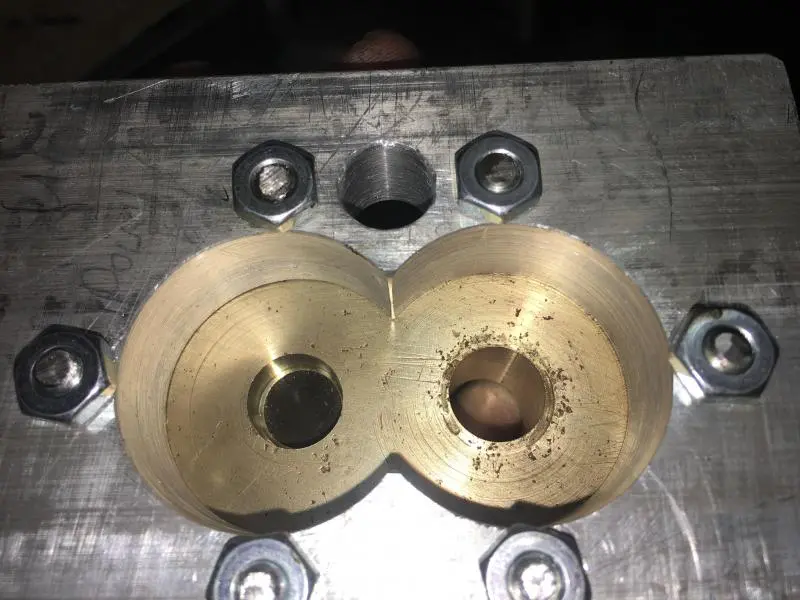

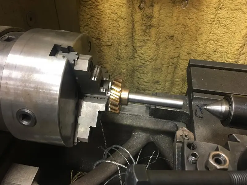

Thought I would share some pictures of a repair I did on a Holt 75 oil pump.
The gears were in great shape but the idler pin and shaft were wore so I bumped everything up a 1/16 in shaft size.
Made a fixture to hold the upper and lower halfs in the same position.
Finished it off with a new drive gear and new drive shaft.

What's that chuck on? A VTL? Bullard? Pump looks good.
Tue, Jul 4, 2017 8:04 AM
Holt2ton
Send a private message to Holt2ton
Posts: 89
Reply to STEPHEN:
Yes a 42" Bullard.
