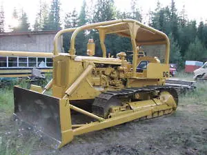

Hi All : 👋
I have read many posts here, and believe there are many people ( old hands and new ) that know the ropes on dozers, and willing to help others.
New here today ... asking for info:
I have found a D-6 9U they say 10K and that is all I know.
My question are ... how much do you believe it weights, what year is it, over all length, track width, it also has a rock hydraulic type
blade with two winches on back for a scraper.
Pony motor has been overhauling, runs good, and so does the dozer diesel motor.
How big of a cable scraper could this dozer handle in your opinion ?
Owner says it was used in the Air Force Military in the past.
New paint, has factory safety roll over protection from front to back, tracks are in good shape, grousers have had extra bars welded on from the past, sprockets are good with square tips and not sharp points, rollers look good from what I have seen from pictures.
Standard shift, Manual tilt, no angle.
They say under carriage is about 70%.
What is an average price range in your opinion ?
Ask me any question, and any help would be appreciated ! ! !

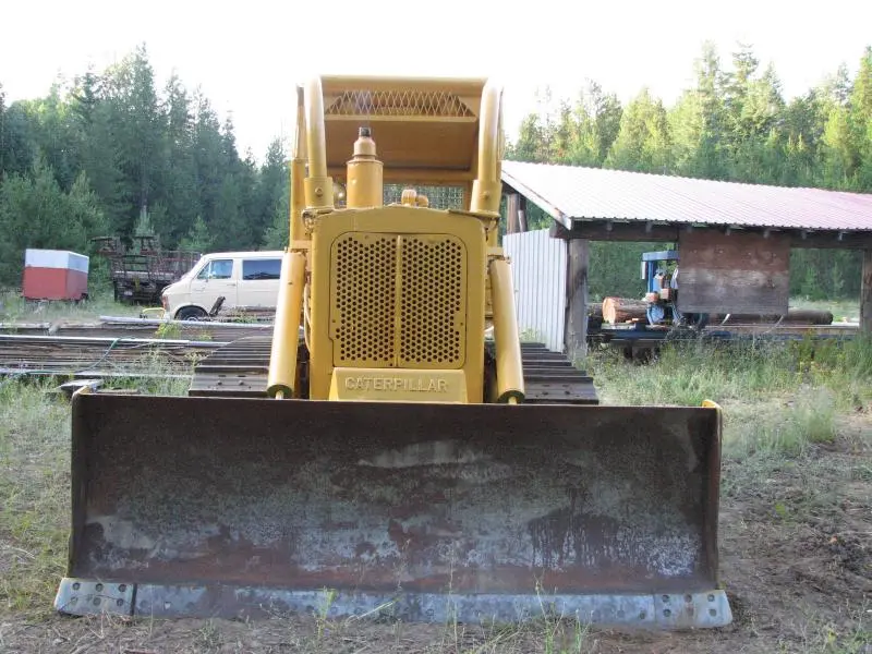

Hi Bumpus,
I'll start by answering some of your questions:
Need the serial number to tell the age for sure but appears to be an early model cable straight blade that has been home/shop converted to hydraulic dozer.
Typical scraper match would be a Cat # 60 cable scraper...6 cubic yds struck, 7.5 heaped.
Can't tell to much from those ebay pictures....need closer look to assess and undercarriage needs to be measured.
Far as price I'd be starting at about half that asking unless there are some really good condition features.
Here are some basic specs which would need to be added to for weights/width of dozer, CCU and cage, etc

Judging from those sweep mounts on the radiator, I would be suspect of "full factory safety ROPS." The pictures don't show the rest of the fabricated ROPS, but it's better than nothing. Judging by the fabulous graphics, I'd be inspecting the machine in person. A free-hand brushed on "D6" makes me wonder what other shortcuts they made. Dupont overhauls oft times cover a multitude of sins. I agree with OM. The pictures are not clear enough to assess the condition.

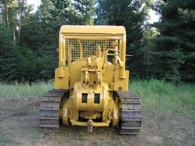

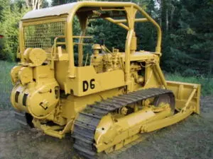

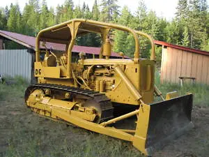

Hi, Bumpus.
I have to say that I'm with the two gentleman above (The guys in the title of this post.). There is not enough detail in those photos to give much of an idea of track condition, or much else for that matter. I also agree that the hydraulic blade lift is highly unlikely to be factory, rather it is a home-made one set on a hard-nose front that probably once carried a cable blade lift.
If I had to hazard a guess, I'd say that somebody put the hydraulic lift on it to free up the CCU for scraper work. If both sets of guide sheaves are showing signs of wear, that would be a bit of a clue.
Not being an authority on prices on the eastern side of the Pacific Puddle, I still feel that somebody has the notion that this machine is covered in gold leaf instead of the highway yellow it oughta be painted.
What's more, I don't care what the ad might say about it, that canopy is NOWHERE near being a ROPS. A genuine ROPS would be capable of taking the weight of the tractor dropped on it from a height of 10 feet without serious distortion. It would also have mounts that would be capable of taking the same impact. Cat did not start putting mounts for such ROPS canopies on its D6's until the D6C. It is simply a brush canopy, nothing more. Don't trust your head to it if you get the machine. If you wanted, you could possibly sue that vendor for mis-representation.
Personally, I'd go myself to have a look at it. If you don't have sufficient knowledge of crawler tractors, try to take someone who does have that knowledge with you.
Hope this helps.

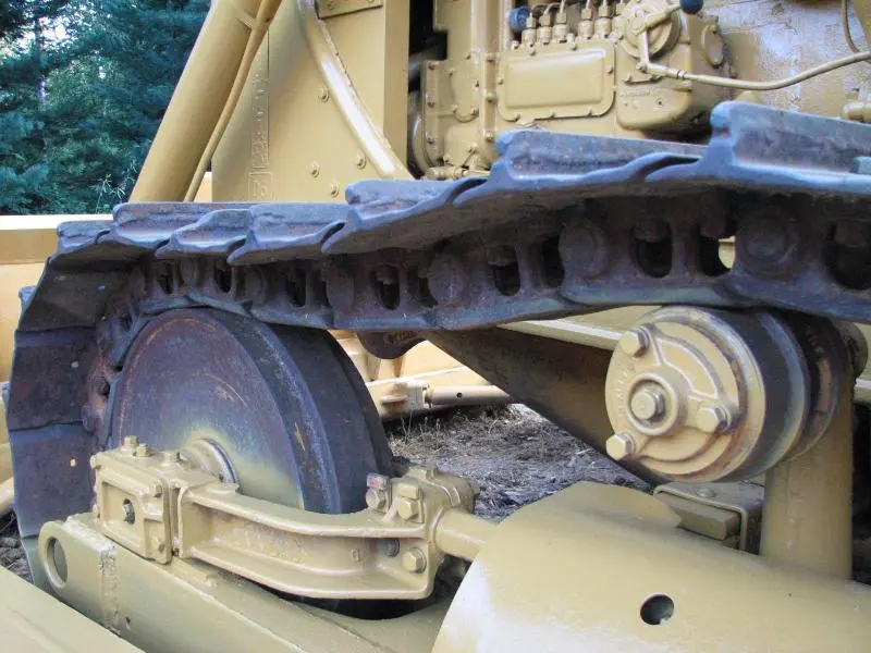

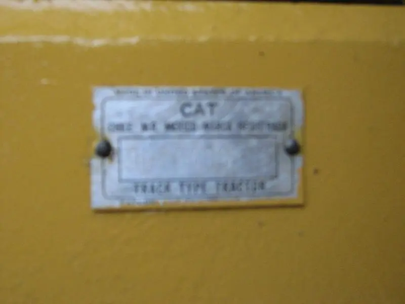

As stated we cant tell you the definate build year without the S/N.
This tractor is fitted with solid front idlers and the upgraded idler mounting which came in at S/N9U28328 idicating that its going to be a 1959 build. Having said that its possible that the machine is earlier and may have just had "upgraded" solid idlers fitted at some stage.
Serial number is the way to go if you want to tell for sure. The engine S/N number is located on the left hand side of the engine block behind the pilot motor clutch. The Chassis S/N is located on the top LHS on the back of the transmission case. If the tag is missing the number may be stamped into the cast.

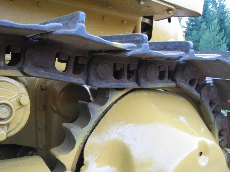

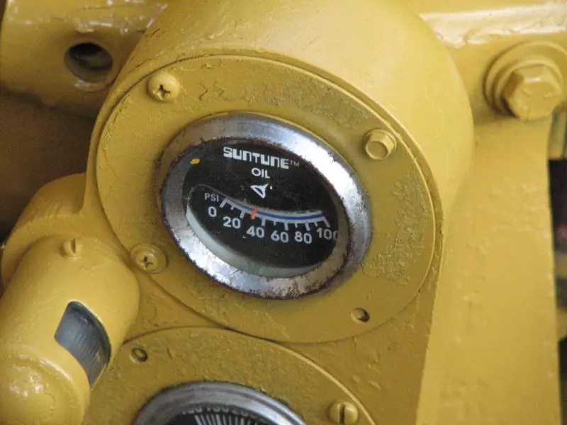

These are some other picture he sent me.

Stumbled across the ebay ad......I see the asking start bid at $5.5k, don't know if that's original asking or not but makes it worth investigating. I don't think it's a bad dozer, just needs to be checked out. Get off your duff and go check it out......anythings better than operating a "rocking chair".
