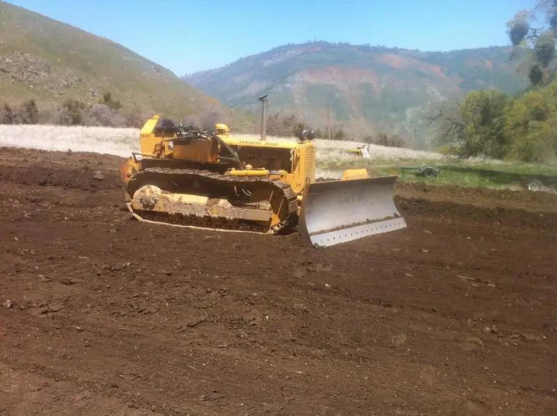

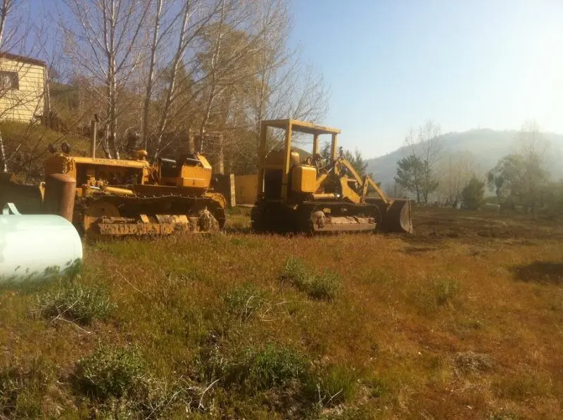

I got both tractors out on the job site earning some $$$.
He told me "I want you to build a pad in this area and walked away". It's been a good learning experiance getting out there and figuring it out. I applied everything I've learned from all you guys and it turned out pretty good. The Mighty D4 is much nicer to operate with it having a winch on the back. It use to lift the rear when coming up on the blade but now the rear stays planted ๐Ÿ‘
Well Pops, can I call myself a Cat Skinner now?

I am in shock, man it looks good. When I see you tomorrow or Friday, remind me to give you a OPERATOR badge we had made up for Tulare. You are coming round there Oil Slick, I am proud of you Son. I smiled when you commented on how the Mighty D4 is more balanced. You know, some cats out fitted just right, realy click, and others are out of balance or they don't feel right. When you get on a balanced Cat, and it has a good feel to it, your bubble in your behind will let you get some good work done. Good job son. Is D4e bringing the High Horse down on his back haul?

Looks good Mike. .backdragging, er sharpening the cutting edge not only wipes out tracks but can cover a multitude of sins as well ๐Ÿ‘๐Ÿ˜†

OG. when I started the pad I was cutting about 2 1/2' wind rows to make about 5-6' of fill. I was not back dragging during this time just dozing. Once I got the pad close I started on the high side with the blade angled rolling the dirt down hill while keeping the cat level. Now I moved up a half width and back draged with the blade angled the other way. Seems like good buisness to back drag cuz I'm making progress in both directions and time is money.

I do pretty much the same thing. Roughing a road in I don't worry about track marks as the gravel will cover 'em. Then if I'm using the D4 to finish, I spread it going forward 'til I've got almost the width I want. Then it's time to backdrag a bit to cover the track marks and get a smooth finish. As I don't have a roller I'll use the loaded dump truck and wheel pack it for a final finish.
The way I see it, there's no wrong way to get'er dun. Ya just gotta work around what ya don't have with what ya do havet๐Ÿ˜†
