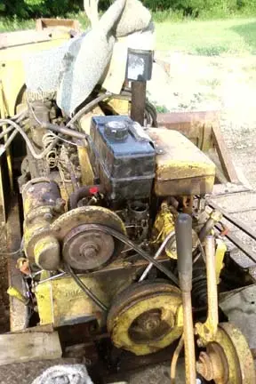

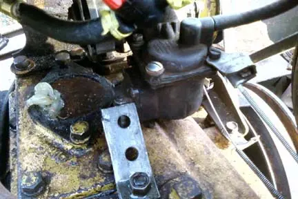

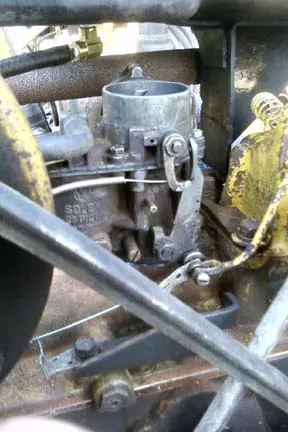

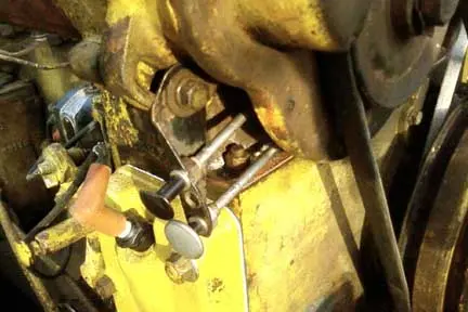

A couple years ago I saw a post on here by someone who mentioned this conversion. I never could find any good pics so I'm including mine. I have to say it runs wonderful with this setup. I recently had a valve job done on the pony (7 years sitting in a barnyard with water at the bottom of the seats). While I had it where I could take pics (on the dozer but not hidden by the sheetmetal) I thought I would share them with you guys. I posted a couple about 2 years ago but hadn't hooked the governor up until recently; which I'm not sure really works but I just take great care not to over rev. This is a 28 pica from early VW. The throat matches amazingly well with the top cover. Problem is though, the carb bolt on the left side doesn't. I ran it until recently with lots a thick coat of gasket maker and only one bolt. It never did seal that well so I have since taken a piece of metal (cut from the hanging hardware to my garage door LOL!) as you can see. It works great. Plenty of down pressure. Linkage was reworked from simple stuff in my catch all bolt can. Well hope the purists won't cuss me too much. I stil believe in ponies and wouldn't waste the time to go electric. I like sittin' there with the pony at about 1/3 speed as long as I need for priming this ol' gal etc. But those early carbs were crap. Oh yeah I also piggybacked a plastic lawn mower tank onto the old rusty orig.
