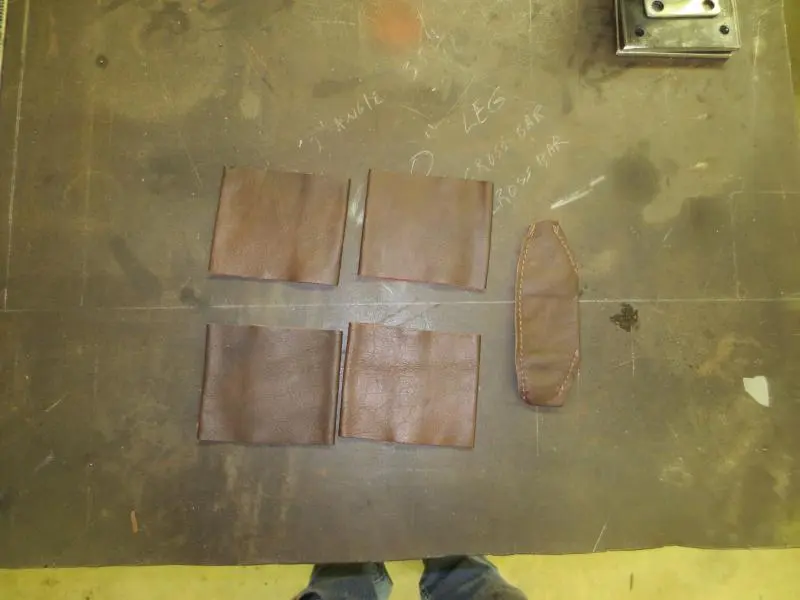

Need some help with these parts.....
First is some leather covers I got with the Cat Ten. I have no idea where they are used. [attachment=14914]Spare Parts 5.jpg[/attachment]

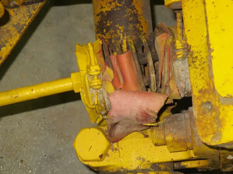

Second.....this may be the answer to the first question .....there is covers/shields for these brake springs.
What are they made from ? [attachment=14912]IMG_0053.jpg[/attachment]

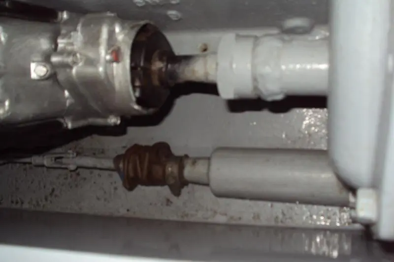

Cysco, the first 3 questions you answered yourself, the 4 ones are from the breaks springs and as you said they are from leather, the 5th on the picture is a leather boot from between the governor rod to the governor housing on the engine (its called bearing by cat) to prevent dust dirt going in the engine.
the vents normaly stick out around 9/16" of the fuel tank thats why there are round holes drilled in the hood, and no water can come in the tank when it rains , but yours look different maybe you can take a close up picture.
[attachment=14916]DSC01909.jpg[/attachment][attachment=14915]DSC01906.jpg[/attachment]
